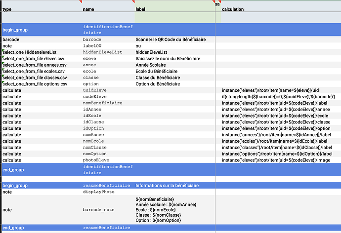

I have :
  • a barcode reader which return a value, $(barcode)
  • a select_one from list from which I can calculate the $(uuidEleve)
The objective is to identify a person by scanning the QR Code, but if it's not readable, we select from the list.
type = calculate
name = codeEleve
calculation = if(string-length(${barcode})=0,'$(uuidEleve)','$(barcode)')
I can't get it work.
May you please help.

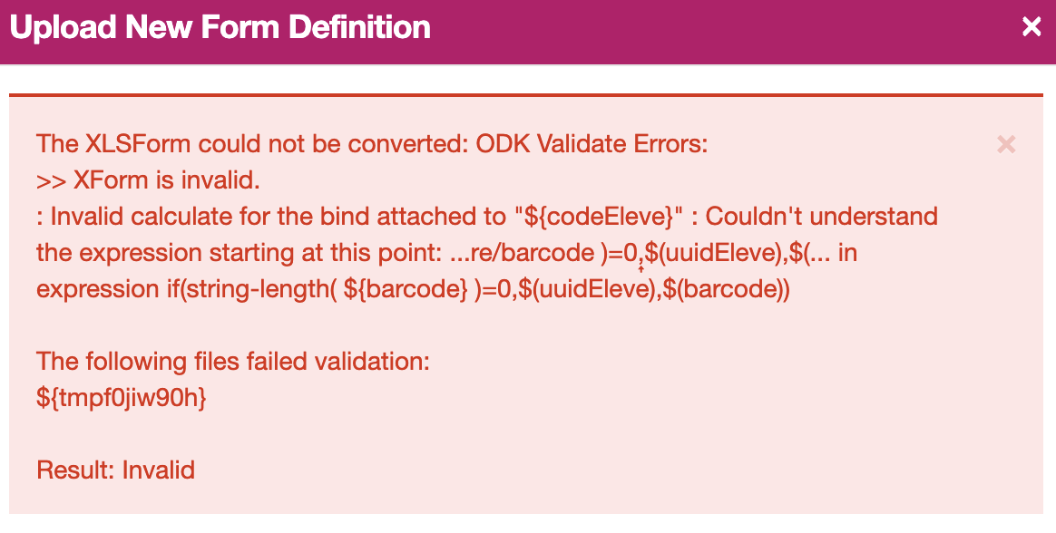

I tried this before, same results. I get an error in odkcollect
I can't even upload the form when I remove the quotes
elevesMinimals.csv (195 Bytes)

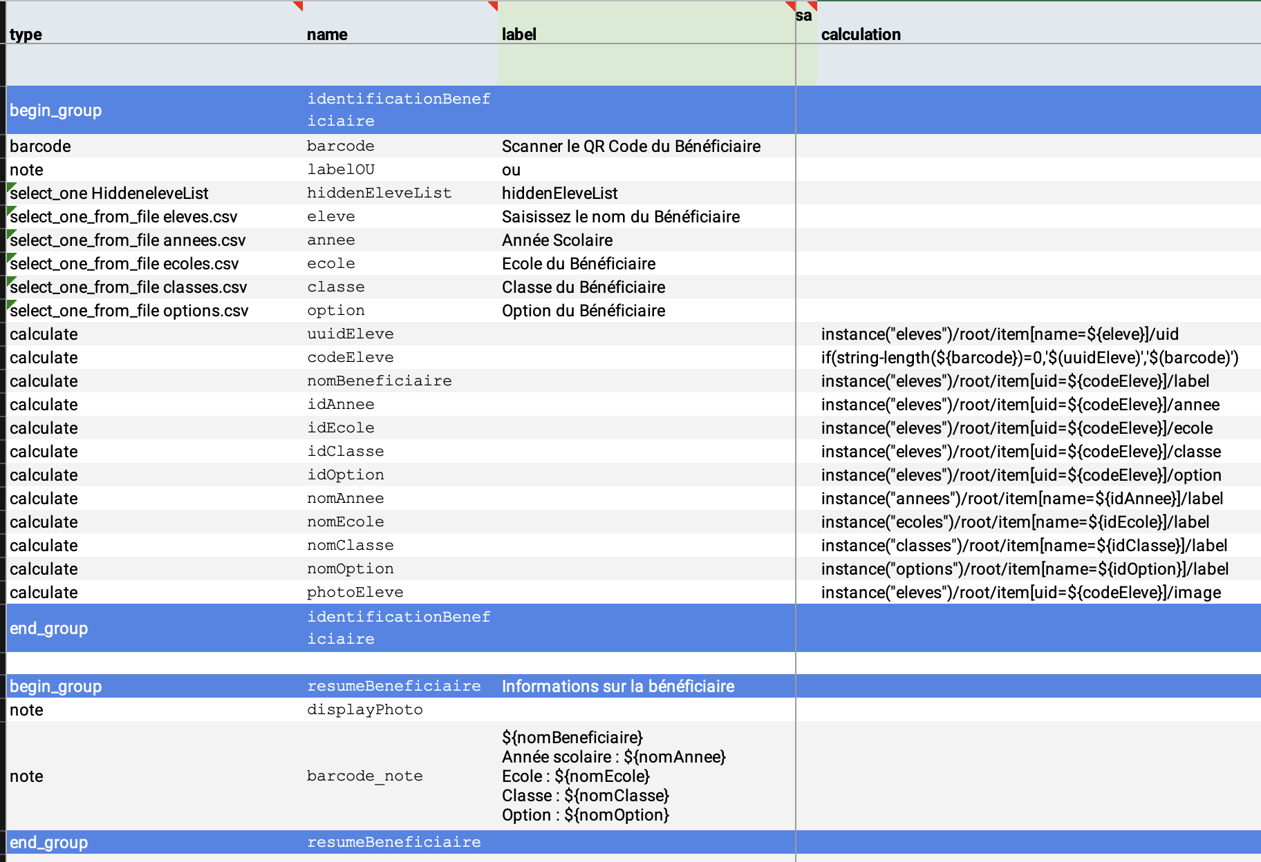

Consultation des Bénéficiaires_Minimal.xlsx (510.3 KB)
Here is the sample of my XLSform

Not only removing the quote, you should use curly bracket instead of round bracket.
${}, not $()
:sweat_smile:
I spent hours trying to figure out what was wrong in my calculation. This is what happens when you switch from one language to another all day long.
Thanks a lot for your support !
