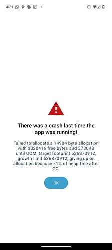

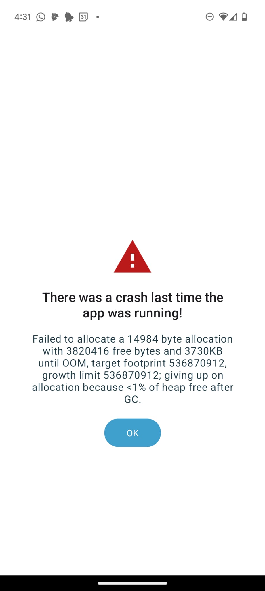

I have a little bit above 75K polygon in as entities with not much more than the geometry and the id of the plot. When open the map to select one of the entites the spinner runs forever until an crash screen his appearing
Have a form which ask you to select an entities at the beginning of the form. Have a bit more than 75K polygons and open the map to select one of the entites
remove some entities but one by one it's very slow and cumbersome. I would like to remove half of the entities to check if it allow to load the map.
