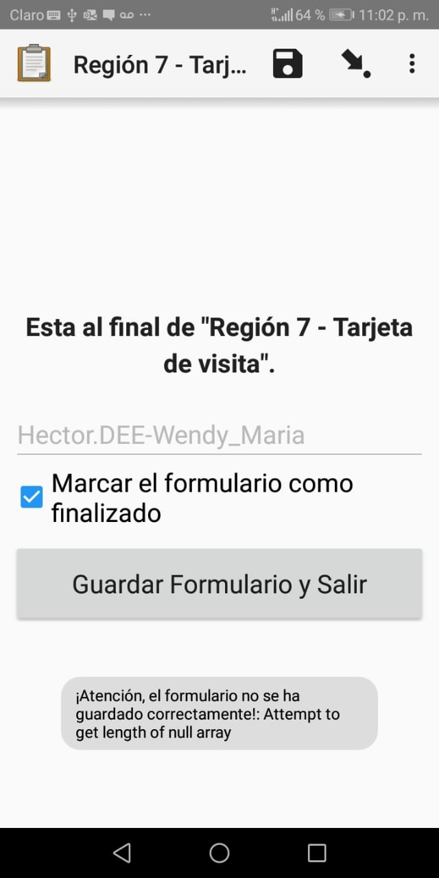

**1. What is the problem? Be very detailed.**
When a saved form has been edited and then saved, appears the message "...: Attempt
to get length of null array". I'm working with at least 75 different users and only one user has reported this problem twice.
**2. What app or server are you using and on what device and operating system? Include version numbers.**
I'm using Google App Engine and Collect v. 1.19
**3. What you have you tried to fix the problem?**
Reinstall the app collect.
**4. What steps can we take to reproduce the problem?**
The errors have occurred when using Vysor complement for chrome. Only 2 times not always.
**5. Anything else we should know or have? If you have a test form or screenshots or logs, attach below.**
 ![42](https://getodk.b-cdn.net/uploads/default/original/2X/d/d020827ac38eef0fa22a94ce589ca15a68f9d0cf.jpeg) ![42](https://getodk.b-cdn.net/uploads/default/original/2X/d/d020827ac38eef0fa22a94ce589ca15a68f9d0cf.jpeg)

That's a good question. I'm not sure but i guess it might have something to do with new line chars in form name. I was working on that issue (new line chars) some time ago and this error seems similar so I think it can be already fixed. If not please attach your form.

> [@Grzesiek2010](#):
I asked to reinstall the app, so if it happens again it's gonna be with the latest version. I'll be expecting.
