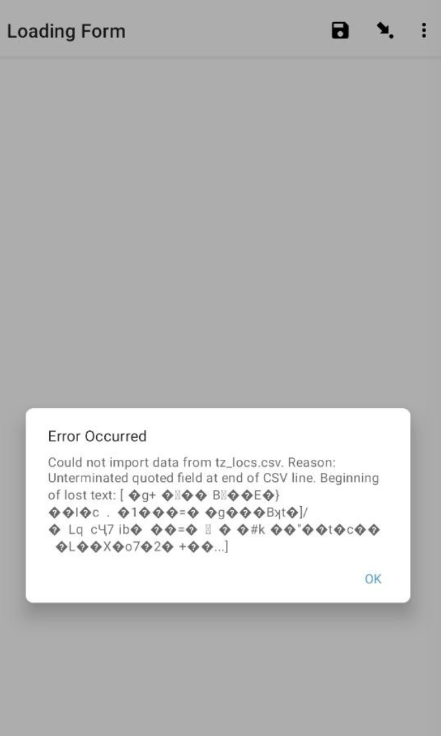

Another, error B on loading the form:
caused by adding a line Lindi,Lindi,Kilwa,Kilwa,Kiranjeranje,Kiranjeranje,X,X

As another interesting piece of information, if I create a new draft from an existing, working form and download the CSV in question and reupload it as a media file (without even opening the file) I get these failures (in my case Error B - the one about unterminated quoted fields) despite the published for working fine.
