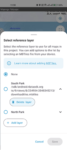

The beta also adds the possibility to delete mbtiles files from Collect's storage:
Note that the icon for that delete button is currently a + when it should be a :wastebasket:. We'll get that fixed shortly but it should not affect behavior.

  • ⌄ button on RHS opens up 'Delete layer' button, delete works as expected, with confirmation.
    • (bonus, it shows the path and filename, which is very useful, especially as if you render a tileset out in QGIS the title is the filename, but if you rename the file post render, the title doesn't change.)

The added function is helpful but it's not immediately obvious that you can also delete a layer, so suggested edit to the text on the 'Select offline layer' screen:
Select the offline layer to use for all maps in this project. You can add layers to the list by selecting an MBTile from your device and delete existing layers from the list.
