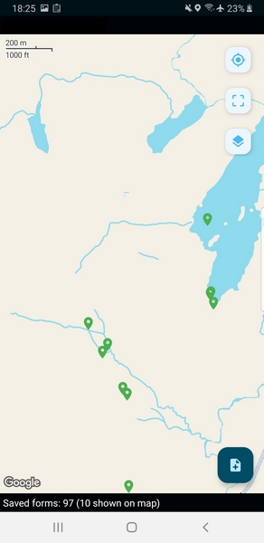

When collecting data using the ‘saved-forms’ map accessible via the map button is really useful to see progress
But can’t functionally be used to navigate to another pre-defined location. To do that, if the locations are pre-defined as entities, I need to put a question at the beginning of the form: select_one_from_file with map appearance. But this can cause confusion as to where to find data between field recording points. Previously I have used offline layers as base maps for this purpose, but entities provide much greater power / flexibility in fieldwork planning…

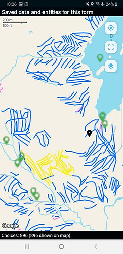

I have tried to imagine what it might look like:
A (real) saved-form-map … … … … An entity map for the same form (yellow are updated entities)
A combined map (not very effective visualisation!)

What's the relationship between the points representing the completed submissions and the Entities? It looks to my eye like they're mostly unrelated. I would generally expect that you could change the status/color of already-visited geometry. It sounds like you've done that with the Entities that are shown as yellow AND have markers for submissions that represent a different kind of completed work.
The submissions include a photo and so the point relates to that location (and the survey was looking at the entities but also recording things nearby that do not directly relate to the entity - so some of them coincide and some of them don’t). The black marker is actually a new entity, created on another device, but the existing entities are lines in this case. The form updates the colour of the entity when visited for this survey (and again when verified). So in this scenario the verifier may not have the submissions on their device, but would be navigating between the yellow entities. Wouldn’t it be nice if the entities could include the images that were taken :face_with_peeking_eye:
