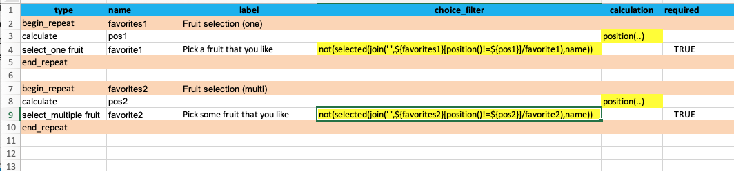

I thought I'd toss my hat in the ring here too... :slightly_smiling_face:
This is a form I've used to filter out previously selected options in a repeat group, either select_one or select_multi. It is ostensibly based on the same principle as @LN's, above.
RepeatSelectDuplicates.xlsx (10.1 KB)

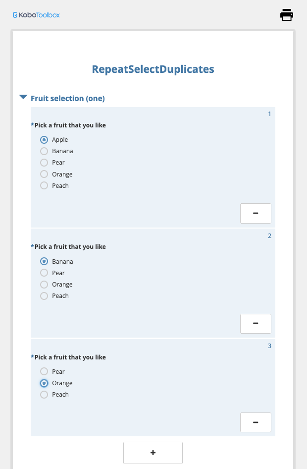

As you can see, subsequent repeat iterations explicitly omit previously selected options from the select (as opposed to LN's constraint check).
Tested and works on both Enketo and Collect, although the behavior will (similarly) be a bit 'odd' if you go back and change selections in a previous repeat iteration... Not implying mine is necessarily better than any of the previous solutions provided here, but perhaps it might give some additional inspiration.
