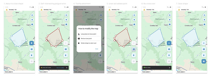

User flow
Example flow using placement mode
  1. The user begins adding points to create a polygon
  2. They accidentally create a crossover, which breaks the constraint
  3. A snackbar message appears, using the constraint message defined to explain why the shape is invalid
  4. The user can tap the action in the snackbar to open a short guide explaining how to fix the issue in placement mode
  5. The user modifies the map based on the guidance (e.g., long press to move or undo last point)
  6. The error is resolved, and the polygon can be saved successfully
