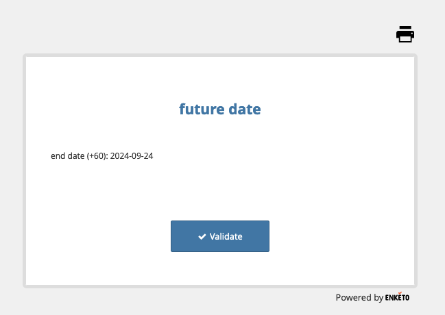

Try this and adapt to your needs:
SimpleForm copy.xlsx (14.2 KB)
Screenshot 2024-07-26 at 8.33.11 AM
Basically, the trick is first convert your start date [I'm just using now(), but it could just as easily be a user specified date question] to a number of days, using the decimal-date-time() function. Then add (or subtract!) to this number however many days you want for the duration; in your case +60. Then convert this new number of days back into a date, using the inverse date() function. ie
end = date(decimal-date-time(now())+60)
I've also tidied up the end date just for display purposes (using format-date()) but this is entirely optional and doesn't affect the calculation.
