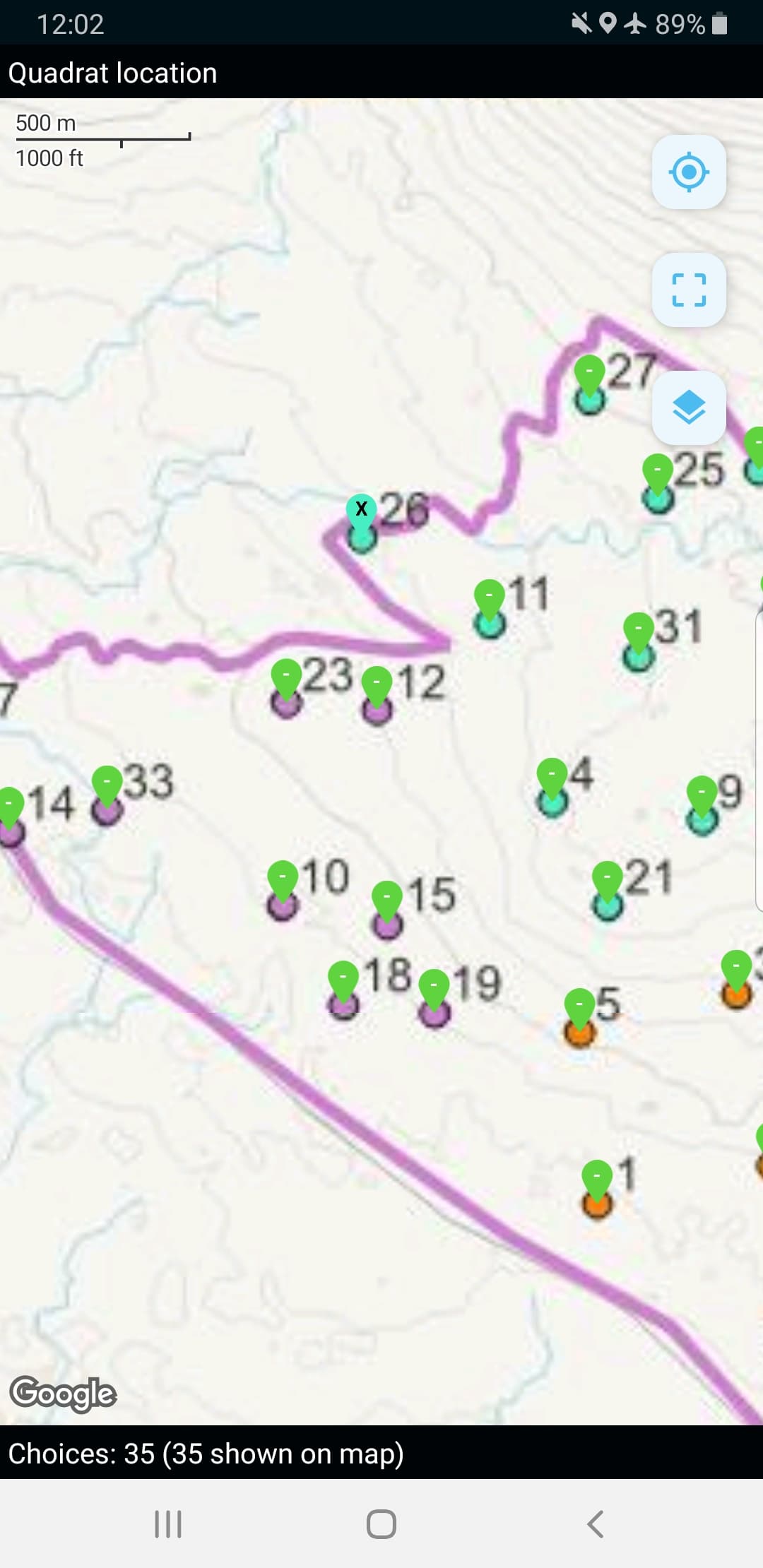

SCREENSHOT: Subset of the data (select_one_from_file, map appearance) - markers are entities and the offline layer shows dots in different colours with plot numbers)

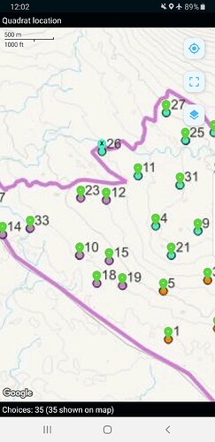

ODK Collect - select Entity from map (on Supervisor’s device):
Note: #26 marker is X and still cyan (not done); all other markers are - and green (done). Offline map layer shows plot numbers

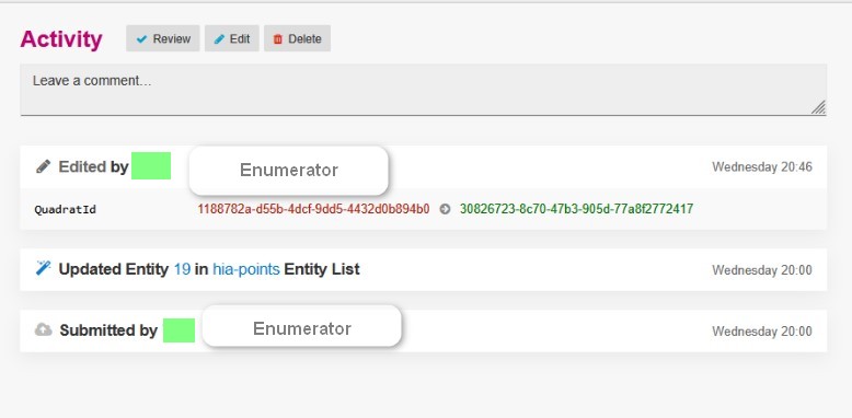

Form submission:
Note that the edited submission (20:46) changes QuadratId (which is the Entity reference #19#26) but does not update the entity itself…

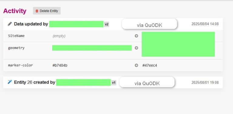

Entity #26:
