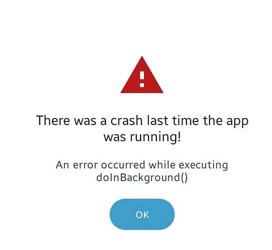

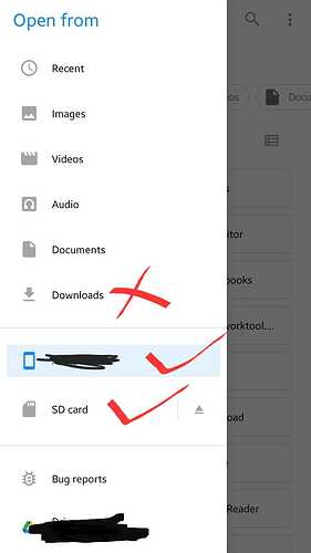

I have observed that the ODK collect (Beta v2025.3.0-beta.2) is crashed when I was using File attachment question and selected a file and it has crashed if I select the file using ‘Downloads’ folder (Samsung A02s, Android 14). Thus, It becomes unable to pick the file from this folder and crashed spontaneously.
The reasons could not be understandable. please provide some advice. is this happening due to Samsung or could it be related to something else. Screenshot is attached. If I select same ‘Downloads’ folder accessing indirectly by first selecting via ‘Internal Memory’ or ‘SD Card‘ then it is working. is this a bug or android problem?

Process: org.odk.collect.android, PID: 17834
java.lang.RuntimeException: An error occurred while executing doInBackground()
at android.os.AsyncTask$4.done(AsyncTask.java:415)
at java.util.concurrent.FutureTask.finishCompletion(FutureTask.java:434)
at java.util.concurrent.FutureTask.setException(FutureTask.java:303)
at java.util.concurrent.FutureTask.run(FutureTask.java:322)
at android.os.AsyncTask$SerialExecutor$1.run(AsyncTask.java:305)
at java.util.concurrent.ThreadPoolExecutor.runWorker(ThreadPoolExecutor.java:1156)
at java.util.concurrent.ThreadPoolExecutor$Worker.run(ThreadPoolExecutor.java:651)
at java.lang.Thread.run(Thread.java:1119)
Caused by: java.lang.SecurityException: com.samsung.android.providers.media has no access to content://media/external_primary/file/1000186932
at android.os.Parcel.createExceptionOrNull(Parcel.java:3091)
at android.os.Parcel.createException(Parcel.java:3075)
at android.os.Parcel.readException(Parcel.java:3058)
at android.database.DatabaseUtils.readExceptionFromParcel(DatabaseUtils.java:190)
at android.database.DatabaseUtils.readExceptionWithFileNotFoundExceptionFromParcel(DatabaseUtils.java:153)
at android.content.ContentProviderProxy.openTypedAssetFile(ContentProviderNative.java:814)
at android.content.ContentResolver.openTypedAssetFileDescriptor(ContentResolver.java:2043)
at android.content.ContentResolver.openAssetFileDescriptor(ContentResolver.java:1858)
at android.content.ContentResolver.openInputStream(ContentResolver.java:1528)
at org.odk.collect.android.utilities.FileUtils.saveAnswerFileFromUri(FileUtils.java:96)
at org.odk.collect.android.tasks.MediaLoadingTask.doInBackground(MediaLoadingTask.java:60)
at org.odk.collect.android.tasks.MediaLoadingTask.doInBackground(MediaLoadingTask.java:32)
at android.os.AsyncTask$3.call(AsyncTask.java:394)
at java.util.concurrent.FutureTask.run(FutureTask.java:317)

@M_Asif_Hussain Could you try another app that uses the same method for file selection? Signal is one example. When you try to send someone a file, it displays the same file picker.
I have now tried using ‘Signal’ app and found similar issue. If I directly pick a file attachment from ‘Downloads‘ it did nothing. I have to select the file by via Internal memory or SD Card options. Same issue happened in this case also.
That’s what I thought. It seems to be a Samsung bug. The only difference between ODK Collect and Signal is that Signal catches the exception and doesn’t crash.
