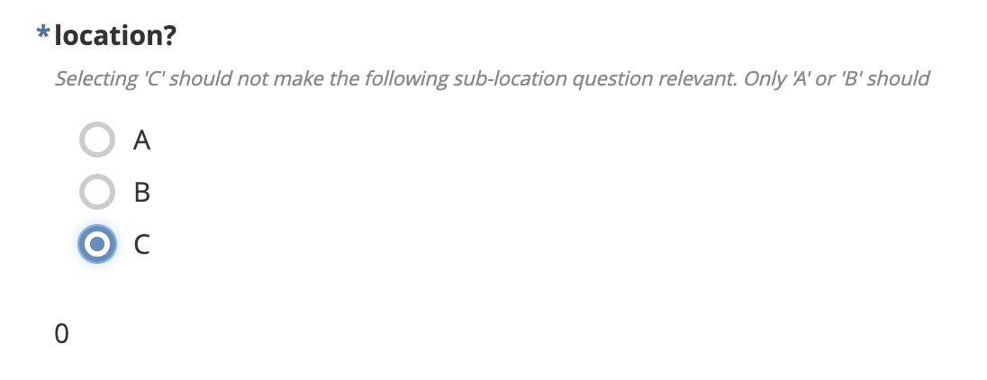

I have a cascading select for locations and sub-locations. Not all locations have a sub-location and if that is the case, I want to use relevant to hide the sub-location question. Is there a way to do this?
I tried what is described in the post linked below, but it seems to always count the total number of sub-location options, not the length of the filtered list.

Your count just needs to be a tiny bit more specific and include a filter to only count those that match location.
count(instance('sub_locations')/root/item[${location}=location_filter])

So as @ahblake most astutely states, you just need to perform a little XPath 'black magic' to include the equivalent cascading select filter into your count() input nodeset. Yes it is a bit obscure, but there is tremendous (hidden) power in these XPath expressions that let you accomplish magical things like this! :magic_wand:
