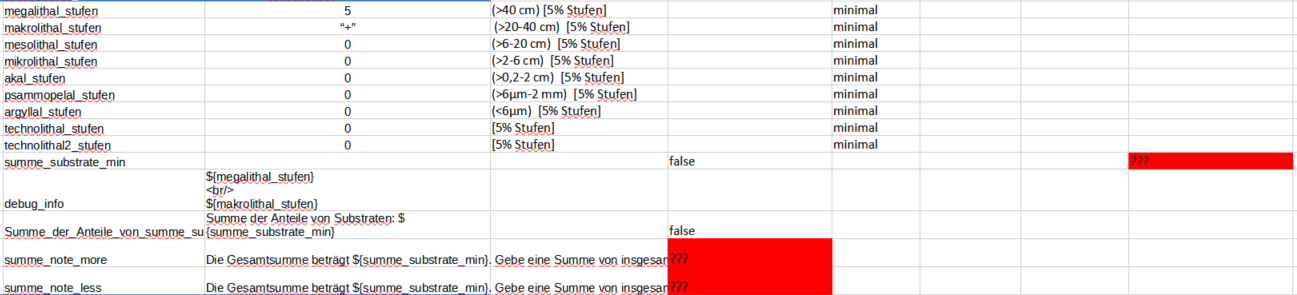

Hi nmambre: yes if also a + is in one of the group of fields the calculation does not display the text and the sum of all fields. All fields at the end should have a sum of 100 for the sum of all. If the user select more than 100 in all fields or less than 100 in line 17 annd 18 it will displayed with a text. If the sum of all fields is 100 not. the actual calculation, if a user select the questions and fill it out, will dispolayed in cell I17 so the user can see, what sum is actual. In addition it should also be possible to enter a + instead of a value.
At my post here: Repeat Function map and Picture and calculate - #3 by Maggi
I got the hint because the sum was only displayed after all fields was filled out, this is why i integrate the cell I14 it will displayed direct after a value was entered.
The sum of row 14 will displayed in C 16. and if it is less than 100 than the text of C 18 will displayed and if it higher than 100 the text of C 17 will displayed.

@Maggi, can you explain, please, what is the meaning of the choice
and/or "+"
From the file, I think you want the sum to just ignore the "+" sign.

@wroos: the + mean that it is not so much to identify as a % stage, like beetween 0-5% it is only "available".
@nmambre : Thanks for the hint to the" if" calculation, I integrate it now, but at the moment there is no difference. The calculation works if I enter only numbers and shows at the end the actual value.... see attached pictures
if it to less with the text that it is not 100 and if I enter exact 100, than only the text that is 100 . Thats okay.

@Maggi
seems ${megalithal_stufen} = "+"
is not working
I changed (only the 1st one) with contains(${megalithal_stufen},’+’)
contains() documentation
I think it should work now, but not sure if we introduced more complexity that is not needed. So maybe someone else will have a better solution.

@nmambre thanks for help, I changed all"+" to '+' but it is the same, after I enter an + the sum and text would not show anymore..... Maybe a idea, to solve it a other way?
Thanks and regards
mst_project-example-test(2).xlsx (18.0 KB)
It's not only changing to '+', you need to use the contains function each time, so each ${var} = '+'
must be changed to contains(${var},'+')
Ohhh, thanks, now I understand....
Now it works perfect.......thank you so much.
Best regards
Maggi
A basic problem is that you use a strange choice naming: '+'. So, your choice name is '+', not +. You should better use something like plus here for this choice name. In general, also for choices, preferably follow the rules for variable names, please, see https://xlsform.org/en/#setting-up-your-worksheets
The name column specifies the unique variable name for that entry. No two entries can have the same name. Names have to start with a letter or an underscore. Names can only contain letters, digits, hyphens, underscores, and periods. Names are case-sensitive.
If you change this choice name to plus, the original solution of nmambre (Defined combination of numbers and text - #13 by nmambre), should work, with just adapting: if(${megalithal_stufen} = "plus", '0', ...
