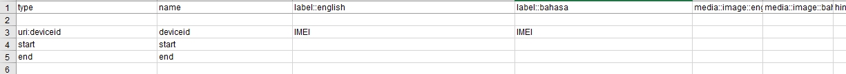

Hi folks, sorry for my newbie question, but I have problem with device ID/IMEI that suddenly not showing up. Herewith the example I got from the user Paloma. Her device was sending IMEI but suddenly empty and this happen with several other users.
Any idea why this happen and what should I do to fix this ? Thank you
