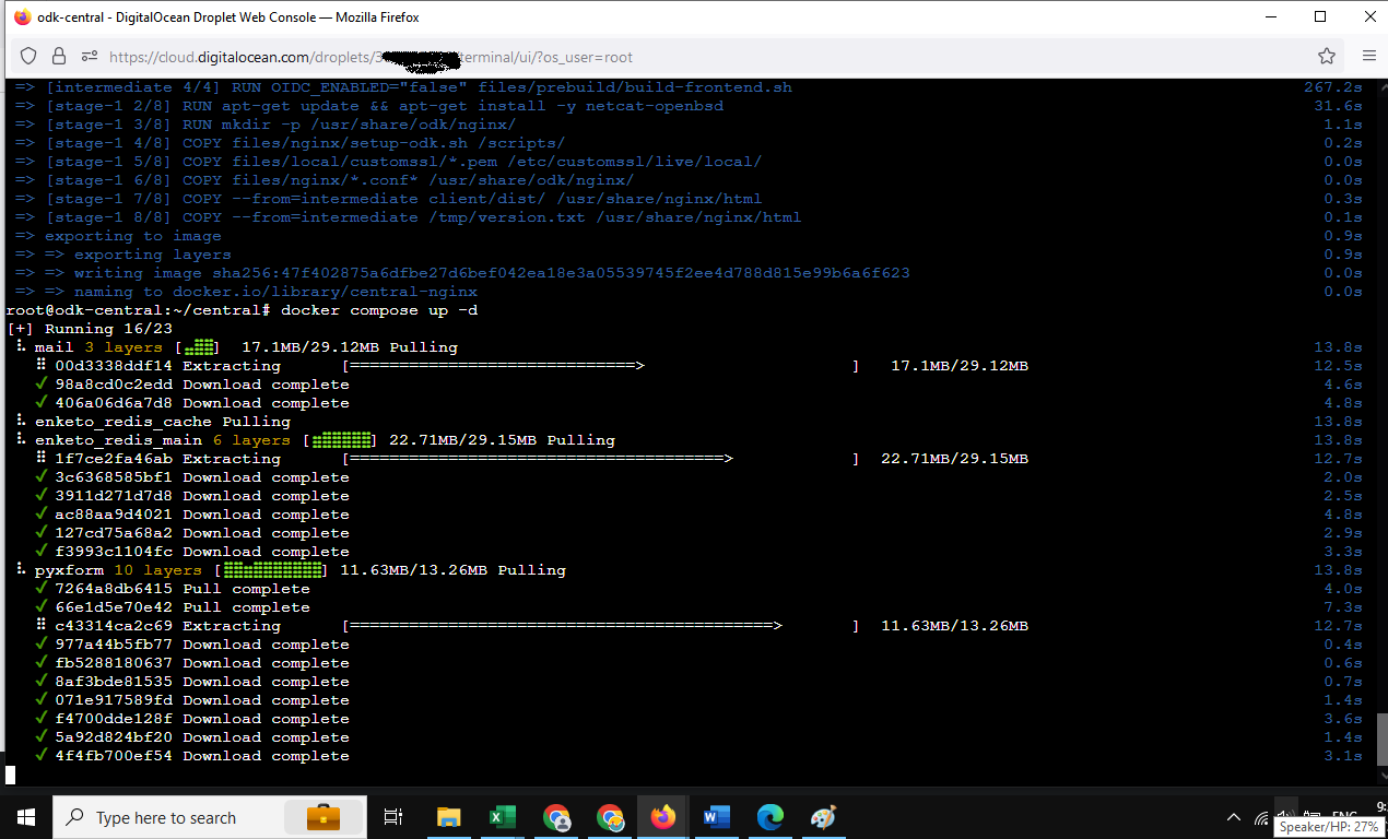

Hi @yanokwa,
I am getting these screenshots in terminal. Previously, installation in Digital Ocean was straightforward, now struggling though followed the doc - https://docs.getodk.org/central-install-digital-ocean/
Regards.
Everything you've showed so far shows that the build is complete.
When you say "Docker build does not work this time" what exactly do you mean? What exactly are you expecting and how do you know that the build is not working?
Hi @yanokwa,
I used the phrase 'Docker build failing', maybe prematurely. Sorry for that. I tried the installation in digitalocean following those commands step by step, but the Central is not starting. I am wondering because my last projects' installation were so straightforward with the described commands. Why is 'docker compose ps' not producing desired screens; 'docker compose build' is not showing "Successfully built" type text after taking 15 minutes.

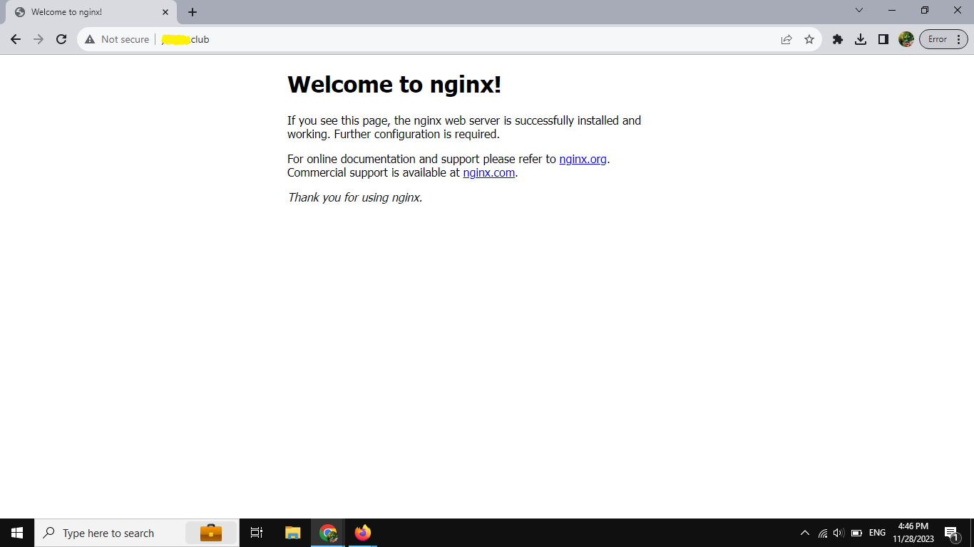

Hi @yanokwa,
I am getting this screen after hitting the domain name which I set in nano. Is there any problem, please suggest. I am finding little struggling this time than earlier, to install the ODK central.
Regards,
Raj
Read your nginx and service container logs. What do they say?
