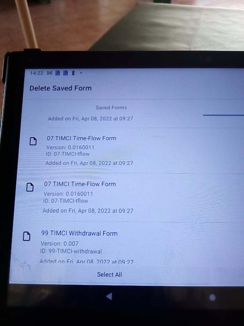

We just got this week one isolated case on ODK Collect v2022.2.2 for a project set up using an app user configuration code (so exactly match server settings). My initial hypothesis was that this tablet may have been used by my in-country counterpart when testing drafts before publication, as this is where I had previously experienced (rarely) this issue and I think what you had mentioned in another thread on the forum, but when checking the saved blank forms, it seems that the two forms with same ID/version were added at the same time on the device. Maybe a network issue that resulted in a request duplication when retrieving the forms?
The problematic blank form was successfully deleted and collected data properly transferred to the ODK Central server (v1.4.0), so I am documenting here in case it might be helpful somehow. Also let me know if any additional information may be helpful.

As luck would have it, I experienced this last week and @Grzesiek2010 has been able to identify the cause. Under certain conditions, multiple requests for the forms are issued and allowed to complete at exactly the same time. We're working on a fix and will release it as a patch.
That's great news, and well done to @Grzesiek2010 and you for tracking down the cause of this unexpected behaviour :clap:
The fix is rolling out in Collect v2022.2.3.
