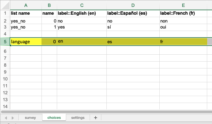

In the following form, I use a jr:choice-name() function to get the translated label for a select question. Because I dont actually want to display this question I always hide it with a relevant=false. For the translated label of the (sole) option for this select I put in the language identifier; in this way, the build-in translation apparatus will give me back the current selected language id! :tada:

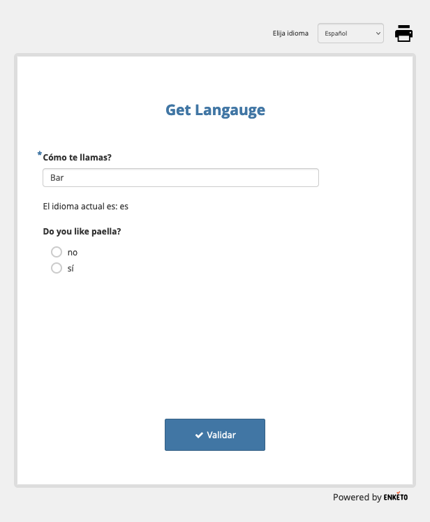

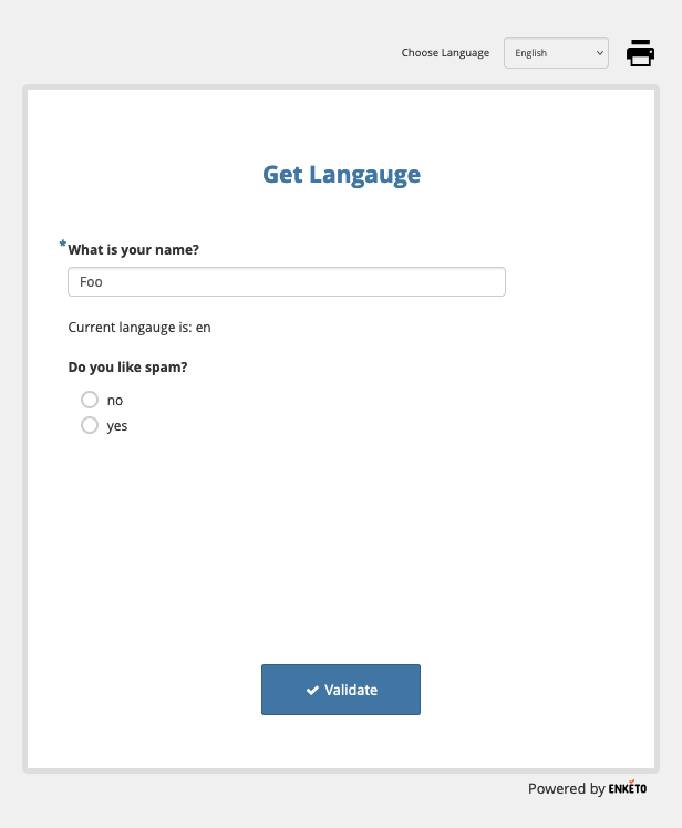

The only complication is getting this to be recalculated appropriately, since changing the language option does not automatically trigger form re-calculations, alas. So instead, I explicitly trigger recalculating the language whenever a specific initial required question is changed (ie name). [if you dont do this, you are stuck with the default initial language, because the language calculation never gets recalculated until you do the final submit, which is too late]. Once you have the language identifier you can, as you suggest, use it in relevant calculations to show/hide different language-dependent form content.
Have a play with this form and see if you can adapt it to your needs:
GetLanguage.xlsx (18.9 KB)
Caveat: you must go back and change the value of the triggering question if you subsequently change your language selection, for language to be recalculated.
