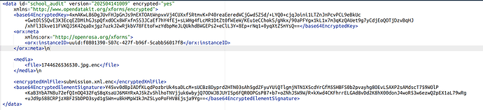

I made an encrypted submission from ODK Collect, and upon inspection, I noticed the root namespace is http://www.opendatakit.org/xforms/encrypted. However, in the ODK XForms Specification for encrypted XForms, it is stated that all attributes and elements should be in the http://opendatakit.org/submissions namespace.
Submissions from Enketo use the http://opendatakit.org/submissions namespace.
The discrepancy is a little inconvenience to our custom decryption library, but nonetheless we are able to handle support for both XML formats.
What is the correct spec? And why do forms from Enketo and ODK Collect have different formats?

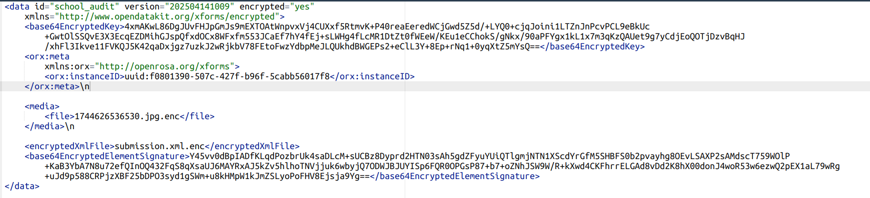

Make a submission from an encrypted form on ODK Collect. Upon submission to the aggregate server, inspect the submission manifest XML. You'll notice that the XML format is different from the one defined in the ODK XForms Specification for encrypted XForms
We've handled parsing of the different formats during decryption.
ODK Collect submission

In general, Collect is the reference implementation and what we tend to consider "correct." That said, unfortunately, a lot of Collect's original behavior wasn't formally documented so it had to be backfilled. In particular, Martijn, Enketo's original creator, wrote a lot of the spec from looking at Collect code. Sometimes things like this were missed.
Namespacing is not supported very consistently across the ecosystem. In practice, it's often acceptable for compatible tools to ignore namespaces entirely because there aren't many documented form spec additions in alternate namespaces so conflicts are very unlikely. In this specific case, ODK implementations that work with submissions strip the namespace from the submission block, for better or worse.
