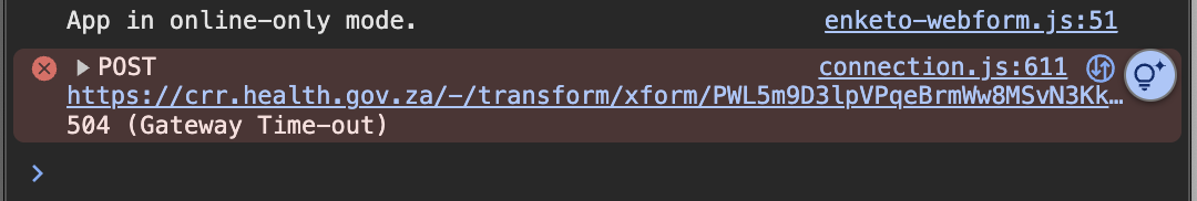

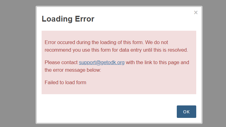

I have an XLSform that is successfully validating, but does not load in Enketo during the testing in Central. Gives an error. See screenshot below:

I notice your form has 16,482 options on the choices tab, which is probably more than the average form. And the browser shows a 504 time-out error.

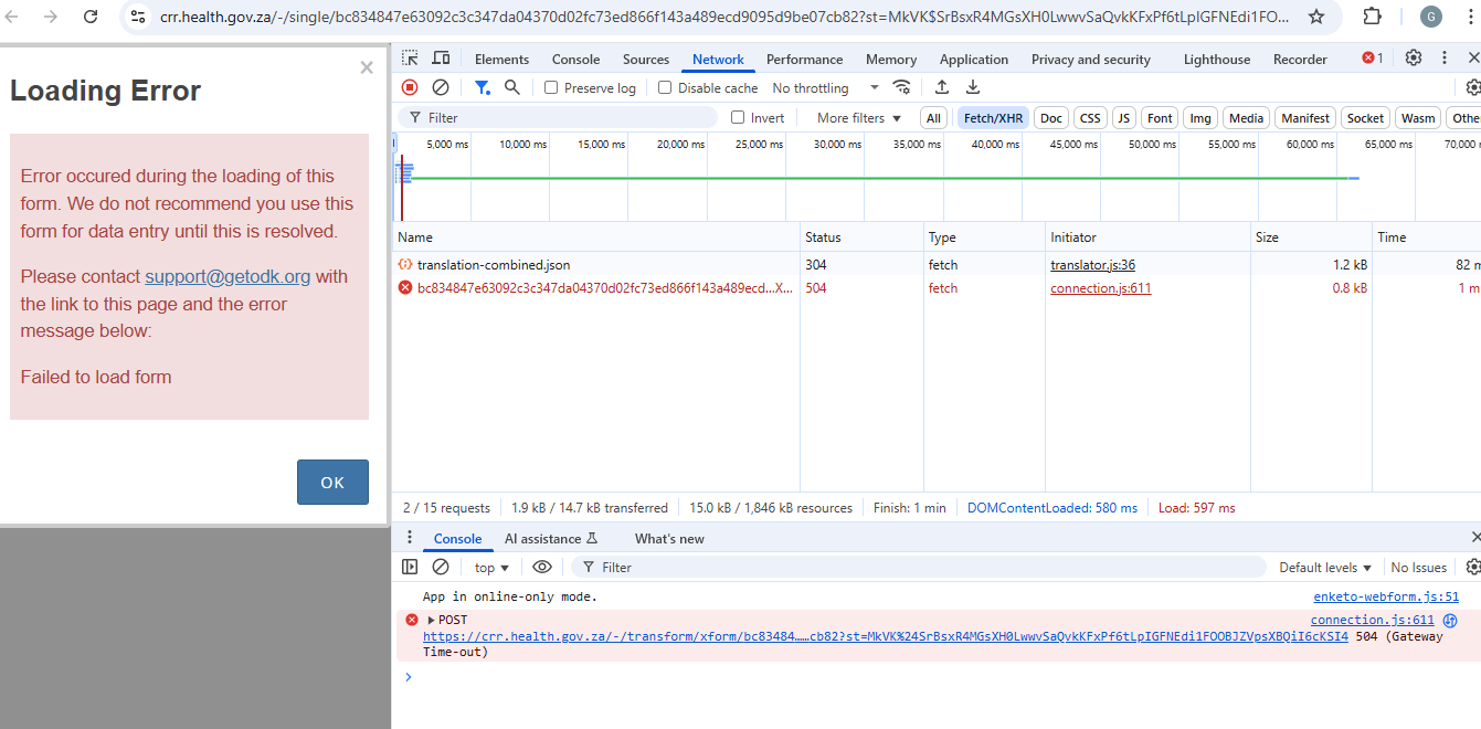

I ran those commands and I am getting zero(0). What could be the problem /cause? I need this to work so that non-Android users can make submissions using enketo forms.
Good day Yaw,

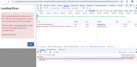

I am also seeing this error :
Those commands test whether Enketo can go out on the Internet and access your own domain (https://crr.health...). It's failing because of how your network is configured. It's usually because of a DNS issue. That's something you'll need to talk with your IT team about.
