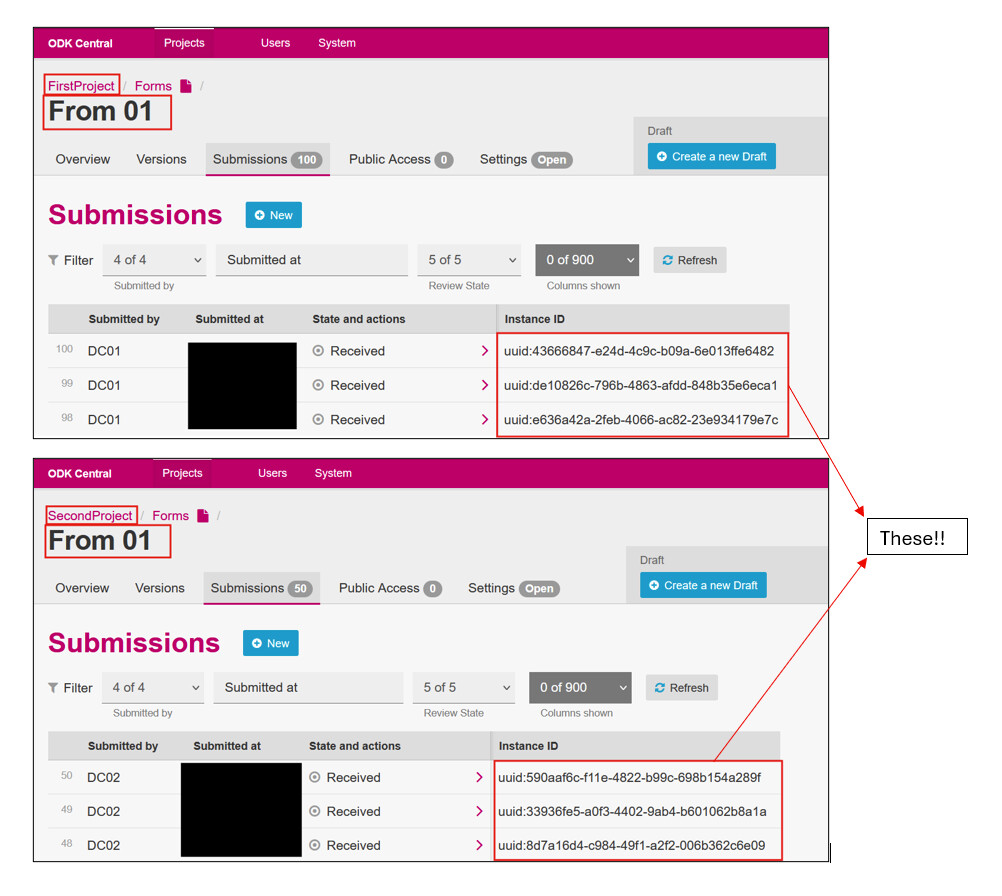

I believe it's preferable for UUIDs to be globally unique across the entire server, rather than just within individual projects. The main reason is that in certain scenarios - such as when appending or aggregating data across multiple projects (forms) or entity lists - it's critical that UUIDs remain unique without requiring manual intervention.
Could you please confirm if the same uniqueness applies within forms across different projects as well? Specifically, if I were to append data for the same form coming from two different projects, can I rely on the UUIDs being globally unique? From what I've observed in the structure of the ODK Postgres container, it seems that UUIDs are indeed unique across projects at the server level - but I just want to be sure.
This is definitely true -- if you want to aggregate data across multiple projects, globally unique UUIDs are important. I guess the problem is that manual intervention is currently required for some other reasonable-seeming things that people want to do, like what's discussed in this post.
Which UUIDs are you referring to here?
Hi! I'm sorry for the delayed response. What I meant was: Submission UUIDs across multiple projects / forms:
Thanks..!
Ah, thanks for the clarification!
These submission instance IDs are only constrained to be unique within a form. You could theoretically have the submissions with the same instance ID uploaded to different forms in the same project. If you delete a submission and it's in the trash, you can't re-use that ID in that form until the submission (or form) is purged from the trash.
In practice, these submission instance IDs (and the entity IDs) generated by Collect/another client are v4 UUIDs and unlikely to collide.
