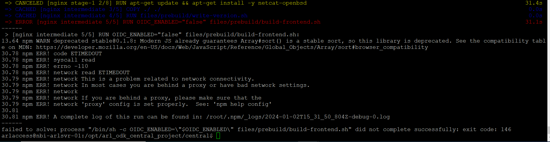

I have an error during installation of ODK Central instance. Ran sudo docker compose build and everything was going on fine till the command: [nginx stage-1 2/8] RUN apt-get update && apt-get install -y netcat-openbsd. The problem is there is no log file to give details about the same issue. I looked into the directory /root/.npm/_logs/ and there is no log file as suggested in the screenshot below.

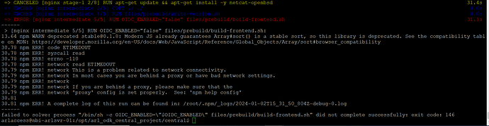

I tried to run sudo docker run apt-get update && apt-get install -y netcat-openbsd but did not manage to install netcat-openbsd. This should work but it didn't but atleast provided a possible cause of the error.
initial error
after running sudo docker run apt-get update && apt-get install -y netcat-openbsd
The initial error from the build says you have a network connectivity problem. Any chance you have an unreliable or firewalled connection? Maybe try a reboot.
Thanks @yanokwa for the reply. I will investigate if the firewall is blocking this specific action because the problem might not be unstable internet. I have repeatedly run sudo docker compose build command and should have passed this point if internet was the issue.
I think you might be right about firewall.
You were right. Firewalls have been blocking the server from downloading some of the pre-requisites. It is surprising that my firewall discriminately blocks certain services.
