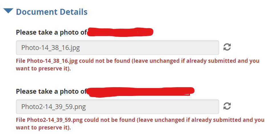

File could not be found (leave unchanged if already submitted and you want to preserve it)
Getting error "File Assessment Order-14_28_36.pdf could not be found (leave unchanged if already submitted and you want to preserve it)." while edit submissions.
Getting this error in all submissions.
  1. Upload new form definition and publish it with 1st version and make a submission.
  2. Update existing form definition with Adding new fields of type file.
  3. Then upload new form definition and publish it with 2nd version and then edit submission of 1st version with uploading file.
  4. Again edit the same submission and scroll down then you will find the same error message in file field section.
Can anybody help please on this issue to resolve it?

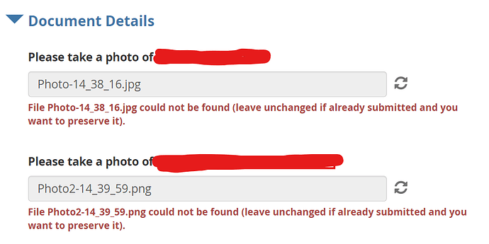

Hello @yanokwa ,
I'm facing the same issue while editing previously submitted forms with images. This is on the latest version of Central, and I don't think it's an upgrade issue. The only difference between has been that the submissions we're trying to edit were submitted on a v2023 version. New submissions do not have this issue. Please advise.
Downloading the data (with media attachments) do not include these images.
