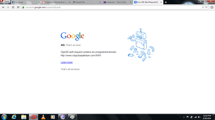

First time log in to ODKAggregate giving OpenID auth error
Dear fellows,
With the help of ODK community I have deployed ODKAggregat 1.4.3 on tomcat with mysql.
On first time log in, when i try to access through my superUser which is @gmail.com, it gives error mentioning OpenID auth request contains unregistered domain.
Please see the error page attached. Kindly guide how to proceed.
Check your logs. You absolutely sure your superUser is a gmail
account? You can also open the jar at
/WEB-INF/lib/ODKAggregate-settings.jar and see what is says in
security.properties
Also, any chance you are changing any of the HTTP headers?

I am seeing the same issue. I think the reason is caused by Google's deprecation of the OpenID 2.0 API.
According to the Migration timetable (https://developers.google.com/+/api/auth-migration#timetable). In May 2014, Google has closed registration to new clients of OpenID 2.0. As such, you're not able to log into any newly setup Aggregate server after May 2014.
If anyone found a workaround, please let me know. I just need a way to log into the server with an Admin account, after that, I can set up some ODK users account and log in afterward with that. Thanks

I have confirmed that this is the case. This will impact the ODK
Aggregate VM and all ODK Aggregate installs not using AppEngine.
The work-around steps are rather tedious:
Aggregate
(1) place the ODKAggregate.war file in the Tomcat webapps directory
(2) start Tomcat so that the war file is exploded in the directory tree.
(3) stop Tomcat
(4) move the ODKAggregate.war file out of the webapps directory for safe
keeping -- leave the ODKAggregate directory in place (we don't want
Tomcat
to ever re-explode the war).
(5) navigate into the ODKAggregate\WEB-INF\lib directory
(6) copy the ODKAggregate-settings.jar to another location
(7) rename the ODKAggregate-settings.jar to ODKAggregate-settings.zip
(8) right-click, choose "Extract all..." to explode this into a directory
tree.
(9) navigate into ODKAggregate-settings
(10) use Notepad to open the "security.properties" file (DO NOT USE
Word)
(11) find the line:
security.server.superUserUsername=
(12) add a username at the end of the line. This will be the ODK
Aggregate
username for the superuser.
(13) save the file.
(14) navigate back up to the directory containing the
directory
(15) right-click on the ODKAggregate-settings directory, choose "Send
to..."
and select "Compressed (zipped) folder"
(16) rename that file to ODKAggregate-settings.jar
(17) copy that file back into the Tomcat webapps\ODKAggregate\WEB-INF\lib
directory (overwriting the original file)
(18) start Tomcat
(19) Choose to Log in using the ODK Aggregate username
(20) enter the username you gave in step 12.
(21) enter "aggregate" for the password
...and please change the password to something other than "aggregate"
Mitch
such,
some ODK
Aaron
