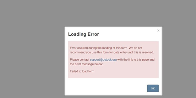

We are able to upload the questionnaire without generating errors, but when we try to preview the questionnaire as a draft or fill out an ODK form online (once we publish it), we receive the following error message:

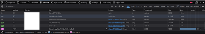

We can trigger the issue by trying to preview or fill out (either as an ODK central user or a web user) any questionnaire online, both in draft or published form. We are using a self-hosted instance of ODK with the following specifications:

c. Bad HTTP requests: We looked at the docker logs as suggested here when reproducing this error and didn’t see any 5XX errors corresponding to anything weird from the server. The process terminated with code 200.
