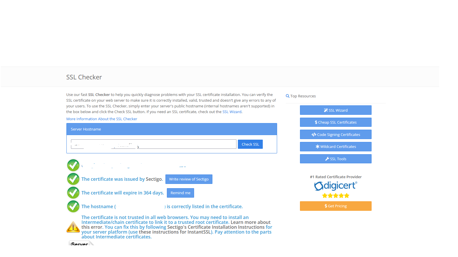

Does the SSL cert at https://www.sslshopper.com/ssl-checker.html look good? You can compare with https://www.sslshopper.com/ssl-checker.html#hostname=demo.getodk.cloud
yes I've checked that, this is the result. @yanokwa

I have merged both SSL and chain certificate using notepad++ and pasted at /data/central/files/local/customssl now it's working fine! :grinning:
