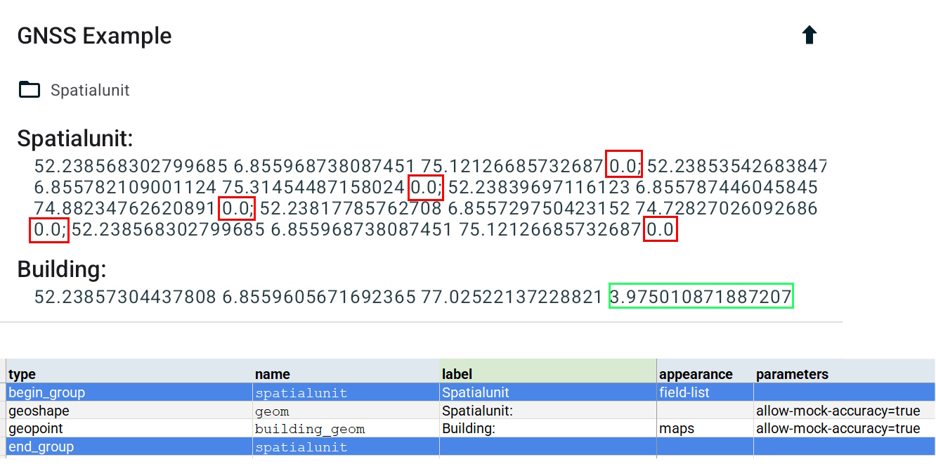

I am collecting geometries in 'geoshape' and 'geopoint' field types using an external GPS sensor. I need the accuracy of individual points so I've added to both fields the "allow-mock-accuracy=true" value in the parameters column. In the case of the geopoint, it works fine. the accuracy is displayed during collection and stored properly. But, in the case of the geoshape, the accuracy display during collection is always 0 and certainly no accuracy is saved once the geoshape is completed.

We are using Manual location recording. The GPS is mounted on a pole, and we collect vertices only when it is placed at the right locations along the boundary of the geoshape.
Thanks! That appears to be a bug. I've filed an issue here: https://github.com/getodk/collect/issues/6657. We'll investigate further and work on a fix.
OK. Thanks!!! I will follow developments closely...
@jmmgnl We’ve released version 2025.1.4, which includes a fix for this issue. Thank you once again for bringing it to our attention!
