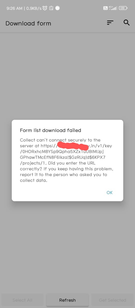

Getting error Form list download failed
Dear support,
Can you please help me with the attached error.
Hi Mohinder,
The error message "From list download failed: Collect can't connect securely on the server" typically means there's a problem with securely connecting to a server while trying to download form. To resolve it:

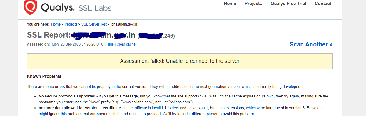

Based on your post at Important file(s) for '/etc/nginx/conf.d/odk.conf' are missing, I'm guessing you don't have valid certs. That's what the "can't connect securely" is referring to. Try https://www.ssllabs.com/ssltest to see if your certs are working.
Yes master, now i am using custom SSL. It seems firewall issue on server side. As output i am geeting "Assessment failed: Unable to connect to the server" in ssllabs.
