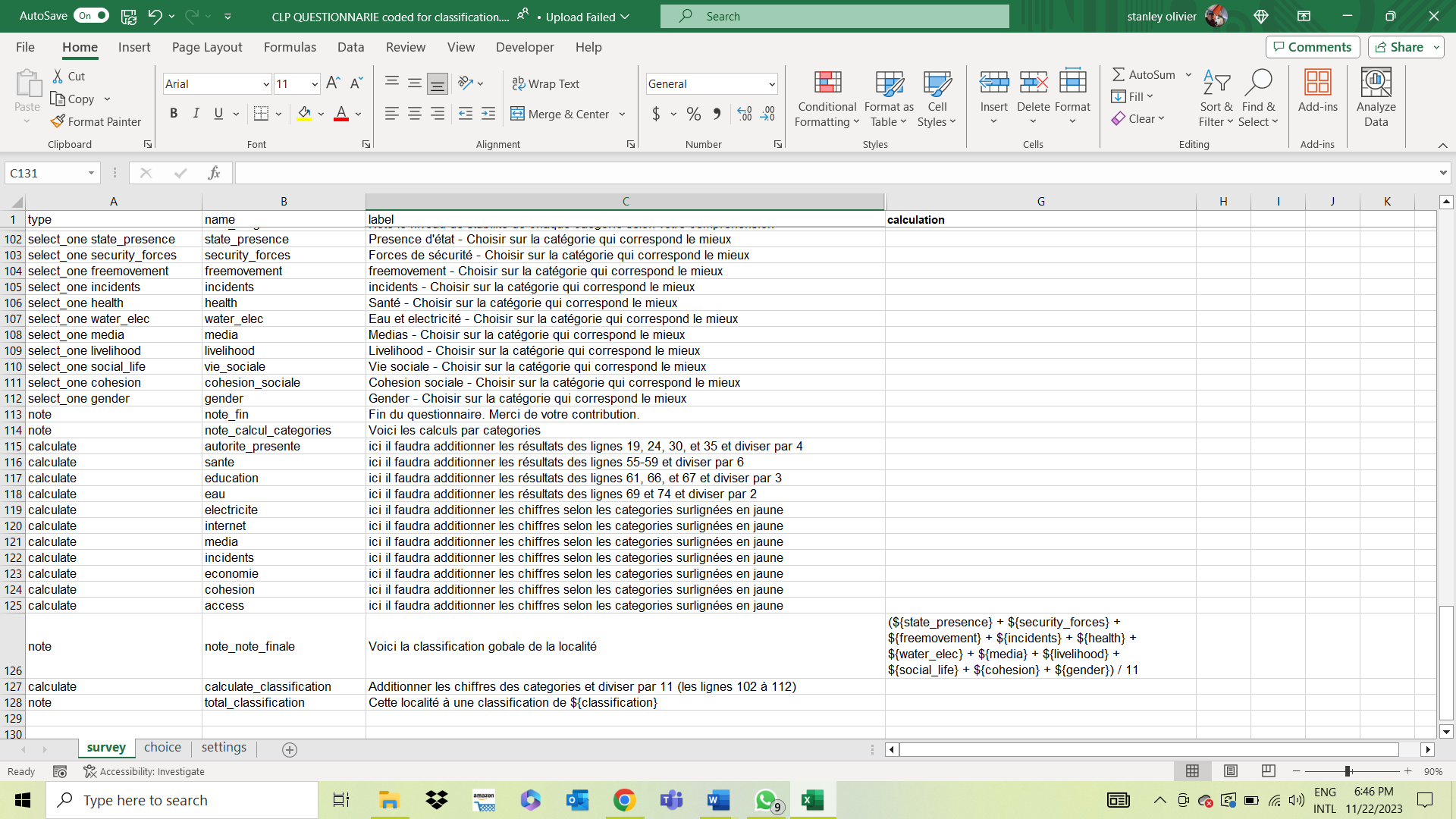

How do I add and then divide in the calculate column
Is this the correct format
(${state_presence} + ${security_forces} + ${freemovement} + ${incidents} + ${health} + ${water_elec} + ${media} + ${livelihood} + ${social_life} + ${cohesion} + ${gender}) / 11
I am adding up the results of a series of responses and dividing the total by eleven in this case. Not sure if I should have 11 in quotations
Thanks for any help.
Your form has syntax errors:
  1. The division operator is div, not /. See https://getodk.github.io/xforms-spec/#xpath-operators.
  2. You have duplicate names for questions: incidents and media. Names must be unique (case-insensitive).
You can always use Central or the Online validator to check your form during development, please.
As selects are stored as strings, you might better add a cast: number(${SelectOneVariable}).
See https://getodk.github.io/xforms-spec/#fn:number.
And if any field can be empty, you need to use coalesce(${SelectOneVariable}, '0'). See https://getodk.github.io/xforms-spec/#fn:coalesce. This function works with strings. An empty field will then count with 0 for your average. If you want to only calculate an average of the sum of non-empty fields, you would need another approach/formula.
So, you might finally best use (number(coalesce(${SelectOneVariable}, '0')) + ...) div 11.
For testing your calculations, you could temporarily change the type to decimal. (Or show them in a note.)

Is this the correct syntax? ((number(coalesce(${state_presence},'0')) + (number(coalesce(${security_forces},'0')) + (number(coalesce(${freemovement},'0')) + (number(coalesce(${incidents},'0')) + (number(coalesce(${health},'0')) + (number(coalesce(${water_elec},'0')) + (number(coalesce(${media},'0')) + (number(coalesce(${livelihood},'0')) + (number(coalesce(${social_life},'0')) + (number(coalesce(${cohesion},'0')) + (number(coalesce(${gender},'0'))) div 11 ?
Sorry, brackets number is unbalanced. The online validator and Central test feature will notice this and show an error. You can remove the one ( before number(..), everywhere.
