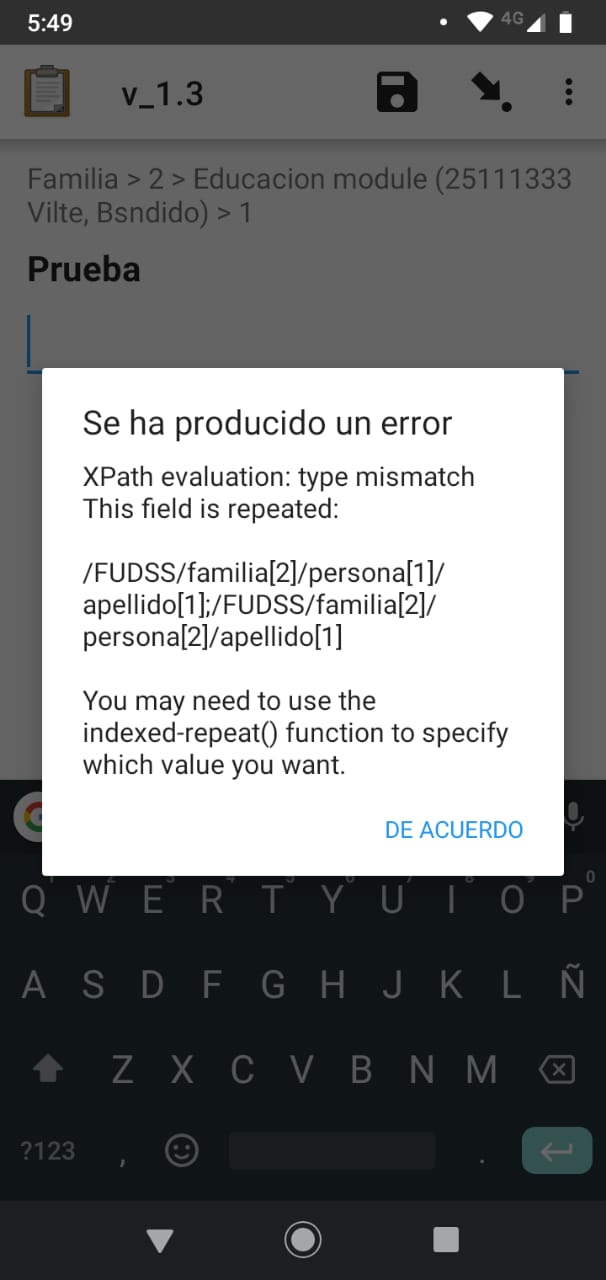

I must do a survey that is separated by modules. Then I make a concat to bring the data from begin_repeat where I have the data that I want to be repeated in the following modules. The error always gives me when I charge the last member.

The error always occurs when loading the last record in the chain.

Hi @Daniel_Alberto_Diaz
I think the error is in cell C24 in which you reference $apellido and $nombre.
Because they are variables included in a repeat group, you should specify which iteration the app should consider. I suggest you create a separate calculate variable in the previous row obtaining the relevant values and then reference these in the cell C24.
See also: You-may-need to use the indexed-repeat() function to specify which value you want error!
I hope this helps!

hi @Andrea_Martin Thank you for your time and knowledge. Indeed that was the mistake, I did not see carefully. Thank you!!!
