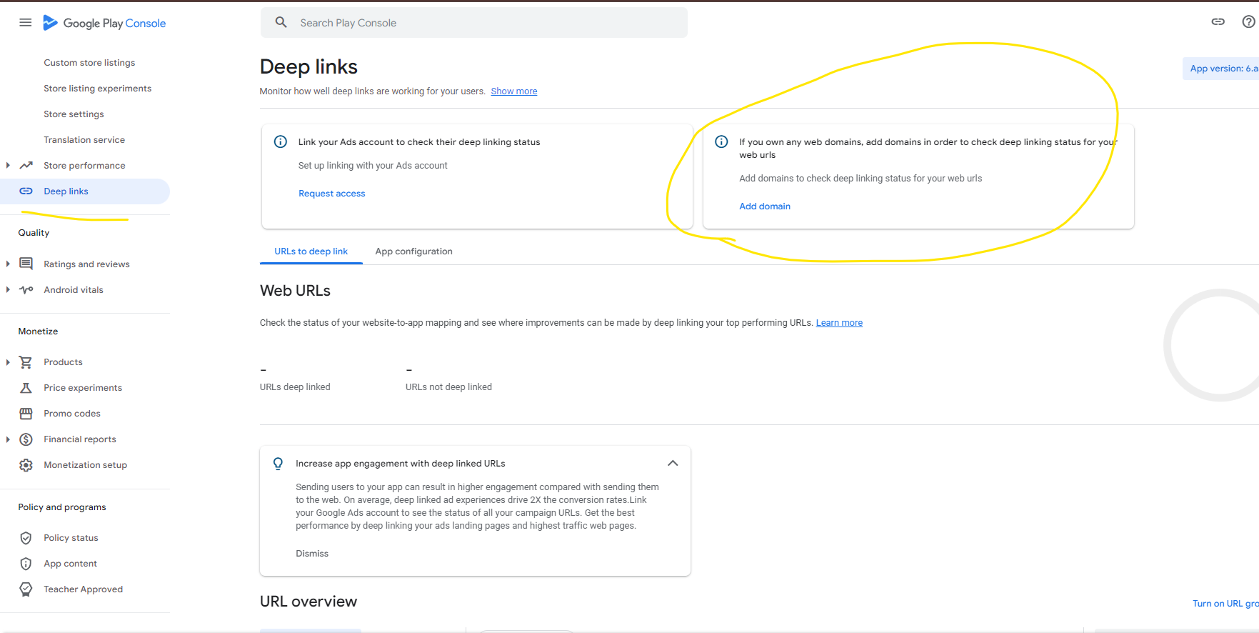

  • As for deep linking, in order to use https:// deep links from a website:
    • The domain must be registered on the Google Play store -> Deep Links section.
    • We must create a Digital Asset Links JSON file assetslinks.json at the location https://yourdomain.name/.well-known/assetlinks.json to declare the association between the website and intent filters.
With this in mind, it seems to me that deep linking with a https:// protocol to ODK Collect may not be possible, as each user requiring this feature will have a different website / domain!
I guess the deep linking capability makes sense when a company wishes to link their website with their app, but for our specific use case I'm not sure anything other than a custom protocol like odkcollect:// will be possible!
We are doing further research to confirm!

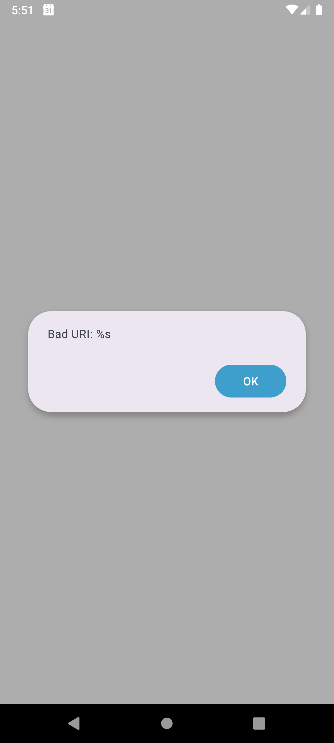

Error Handling
Scenario 1: ODK Collect is installed, but no projects are configured
This error message seems pretty good!
Scenario 2: ODK Collect is installed, and projects have been loaded, but not the project or form required for the intent to work:
This is the existing error - we are looking into updating this to be more like: No project is configured with a form named "My Cool Form". Please ensure the project and form are loaded correctly first.
Scenario 3: ODK Collect is installed, the correct project and form are loaded, but there was an error parsing the URL content:

Scenario 4: ODK Collect is installed, the correct project and form are loaded, but the URL params did not match form fields:
...Screenshot to come...

As a test we developed a basic app and published to the Play Store for deep link https testing.
By configuring the Deep Link in the Play Store settings and updating assetslinks.json with the deep links, loading by intent from a https:// url works for both the officially installed and sideloaded (signed with a different key than the official version) apps without issue.
The only difference being:
Summary
To allow for loading by intent via https Deep Links, we can do the following:
  • Settle on a URL structure such as the one proposed: https://getodk.org/app/collect/configure
  • Add this URL to the Deep Links section on the Play Store
  • Create the file https://getodk.org/.well-known/assetlinks.json including <data android:host="https://getodk.org"> (more details)
The user should be able to load data via intent using URLs like:
Configure project: https://getodk.org/app/collect/configure?data=<base64-encoded-settings-data>
Load form data: https://getodk.org/app/collect/load?d[/path/to/node]=value&d[/path/to/node]=value
