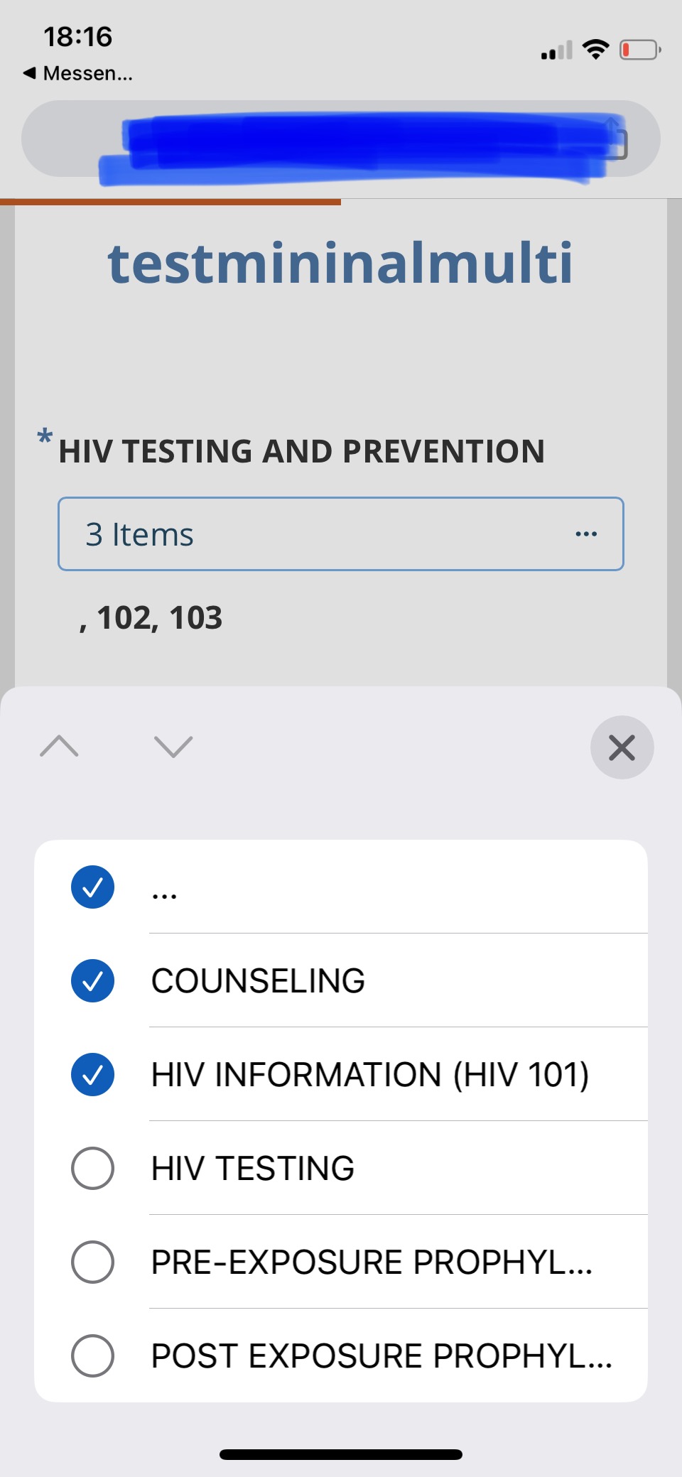

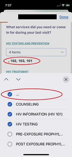

Enketo form displays comma-separated values beneath the input box and the list displays an option (...) that is not in the list of options.
Tried in both iOS and Android devices.
Create a multi-select question with minimal appearance and preview using Enketo. Btw, we are deploying this particular form in Enketo and not in ODK Collect

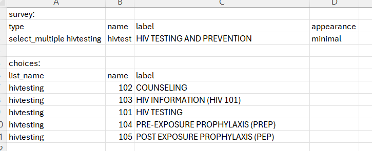

Could you, please, provide a related extract of this choice list or a screenshot, incl. the column headers? Do you use multiple languages?
"With select multiples, make sure that the values you set for name have no spaces in them because selected values are separated by spaces." (ODK labels instead name codes - #6 by LN)

Thank you for your response. No, I don't use multiple languages.

Yes. Only in Enketo and with mininal appearance, and on mobile devices like smartphones and tablets. No problem on a laptop or computer.

It seems indeed a frontend problem on the "mobile" appearance.
I could reproduce it, it appears both for single and multiple select types.
It seems that the "..." replace the "none selected" placeholder in the desktop view.
One workaround would be to switch to the desktop site on mobile, in this case it seems to work.
I also checkee the submission, indeed, the "..." is ignored.

Thank you for looking into this @alfonso . However making it required doesn’t exactly address the issue. It still displays the codes beneath the input box and … still appears in the list.
