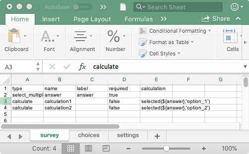

In XLSForm the above XML will look something like this:
XLS
Hope that helps.
