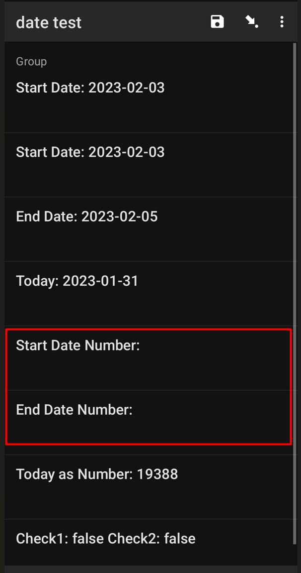

Number(${date}) does not work if ${date} is a datestring pulled using pulldata
I'm trying to create logic in my form to ascertain whether today falls within 2 given dates. start_date and end_date are both calculated using pulldata from a csv file.
As per the documentation here, date-formatted strings are supposed to be converted to number type using number(). This works in Enketo.
However ODK Collect does not do this conversion, and the output remains blank.
I've tested this with the latest version of ODK Collect v2022.4.4

Is there any workaround to achieve this? This is a critical part of my workflow.
Edit:
Enketo Screenshot:
Collect Screenshot:

I even tried doing format-date(string(pulldata(...))) but it doesn't work. Any other ideas? :face_with_diagonal_mouth:
FWIW, this does sound very much like the bug mentioned earlier (https://github.com/getodk/javarosa/issues/405), which is still open/unresolved.
