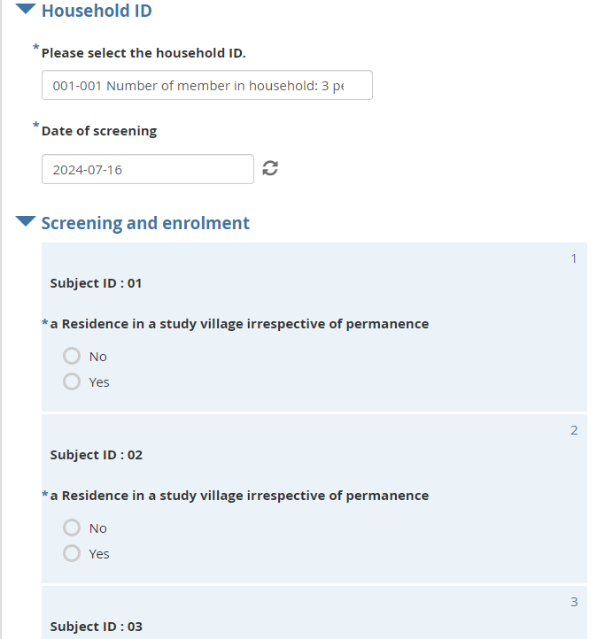

I would like to be able to repeat groups using values ​​from register_001.
In enketo, if there are 3 members in the house, when value coming to the form screening_002 has 3 people and repeats group 3 times,
but in ODK collect app it repeats group 1 time. Could you try to upload and test in ODK collect app to confirm you have the same problem?

Picture from: enketo
