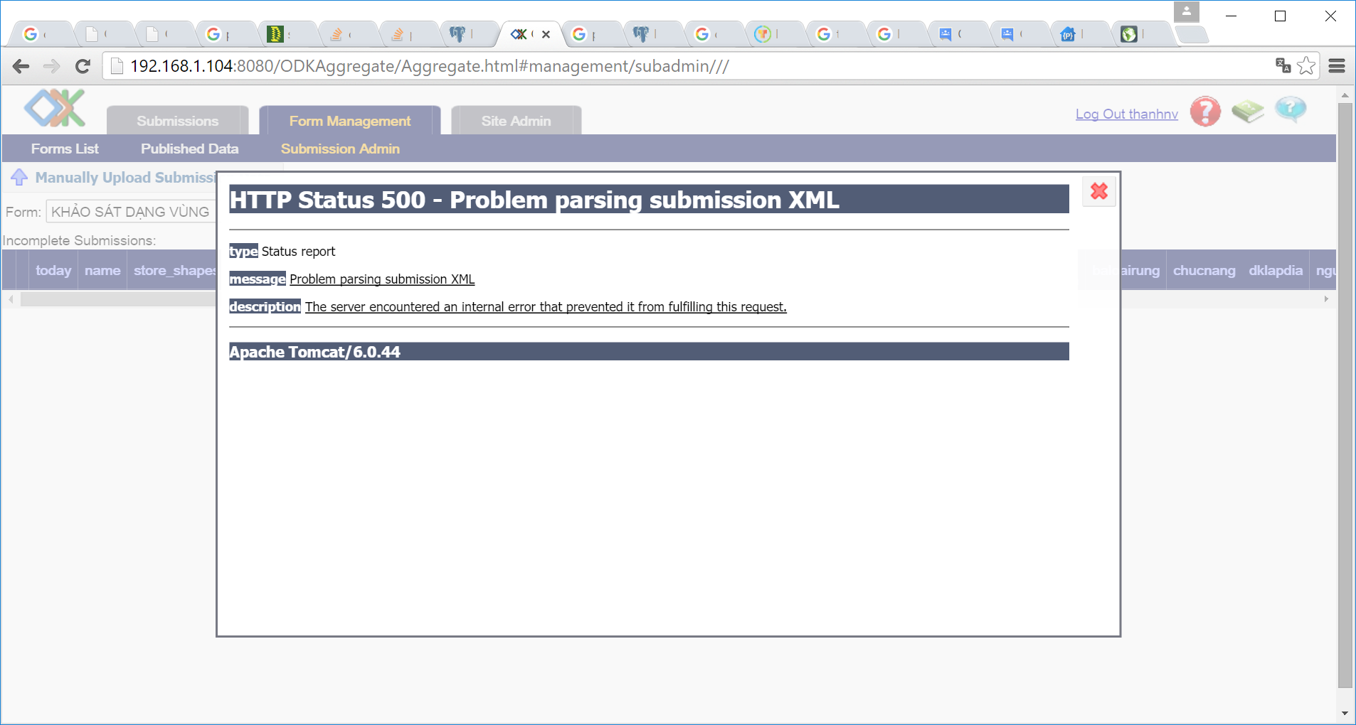

Anyway, my problem now is, every time I place the trigger into the ODK
Aggregate table (one for test first), both uploading data from client
(GeoODK) and also "Manually Upload Submission Data" in Web-based ODK
Aggregate, both ways producing error. Trigger SQL itself may not be any
problem since I can query it and produce a good result. If I remove the
trigger from ODK Aggregate table, data uploading is no error.
Attachments are some detailed information with screenshots and table
structure.
Does anybody here have same problem and have a solution? Or is it a bug in
ODK Aggregate?
Any help are warmly welcome.
Thank you very much in advance.
Polygon.SQL (201 Bytes)
POLYGON_SURVEY_CORE.SQL (4.71 KB)
Trigger.SQL (430 Bytes)

Looking at your files, I believe the trigger insert is failing and causing
the ODK Aggregate to fail.
The root cause is likely that the thanhnv user that is used by ODK
Aggregate does not have insert permissions on the polygon table owned
by postgres

Thank you very much Mitch,
I’ve found the problem before getting your message. The log can be found easily in (my case, Windows 10 64 bit) “C:\Program Files\PostgreSQL\9.2\data\pg_log”. Yes, it is the INSERT permission on the database.
Anyway, I am stuck at converting coordinates data (geo_shape) to geometry. I used ST_GeomFromText but not success at this moment. Do you all have any suggestion?
Regards,
database.
suggestion?
Regards,
database.
causing the ODK Aggregate to fail.
Aggregate does not have insert permissions on the polygon table owned by
postgres

Look in your Tomcat logs for more detailed error messages.
You might need to configure logging on Tomcat to get it to produce
detailed logs. The ODK Aggregate code should log errors of this kind,
but I
have noticed that our recent Tomcat 6 deployments did not produce the
expected (and volumeous) tomcat6.stdout log.
by
postgres

Vào 02:13:05 UTC+7 Thứ Ba, ngày 10 tháng 11 năm 2015, Mitch Sundt đã viết:
Sorry, no.
GIS systems are not my area of expertise.
On Sat, Nov 7, 2015 at 7:42 PM, Nguyễn Văn Thanh <thanh....@gmail.com mailto:thanh....@gmail.com > wrote:
database.
detailed logs. The ODK Aggregate code should log errors of this kind, but I
postgres
On Fri, Nov 6, 2015 at 12:02 AM, Văn Thanh Nguyễn <thanh....@gmail.com mailto:thanh....@gmail.com > wrote:
