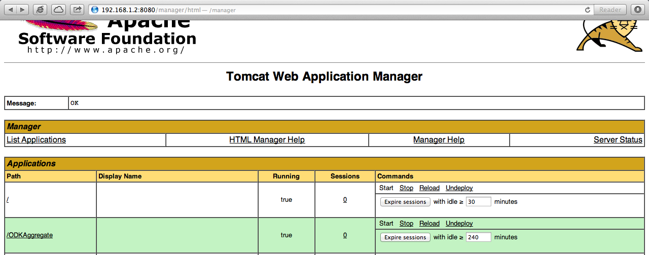

Hi Mitch,
Then, when I go to the tomcat manager app I can see that ODK Aggregate has started on tomcat (attached image).
When I go to 192.168.1.2/ODKAggregate the redirect page comes up, but the form page does not load.
I don't think it is a database problem because I have transferred the MYSQL Connector J's .jar file into the Pi’s /usr/share/tomcat6/lib/
ODK Aggregate loads up through startx when connected to a monitor but not on my remote laptop.
Is there any way you can help me out?

Hmmm. The screen shot shows that you have the Tomcat server set up on port
8080.
The URL you should be using is
http://192.168.1.2:8080/ODKAggregate
And if the page is trying to redirect to port 80 (no port specified on the
URL), then that is a problem. During the install process, on the screen
asking for the IP address, there is a field to specify the port number. Be
sure that is port 8080, or, if you have set up the iptables to route port
80 to port 8080, you can specify port 80 during the install. Also note that
you need to set the firewall (I assume it is iptables) to allow port 8080
(or whatever) to be accessed by an external device.
Some Linux installations have a brain-dead firewall wrapper app that
(re)configures iptables to deny access. Be sure your iptables configuration
is not being overwritten or superseded by something like that.

From my laptop I am able to get the tomcat "it works" page up with
192.168.1.2

Hmmm. The screen shot shows that you have the Tomcat server set up on port 8080.
And if the page is trying to redirect to port 80 (no port specified on the URL), then that is a problem. During the install process, on the screen asking for the IP address, there is a field to specify the port number. Be sure that is port 8080, or, if you have set up the iptables to route port 80 to port 8080, you can specify port 80 during the install. Also note that you need to set the firewall (I assume it is iptables) to allow port 8080 (or whatever) to be accessed by an external device.
Some Linux installations have a brain-dead firewall wrapper app that (re)configures iptables to deny access. Be sure your iptables configuration is not being overwritten or superseded by something like that.
Mitch

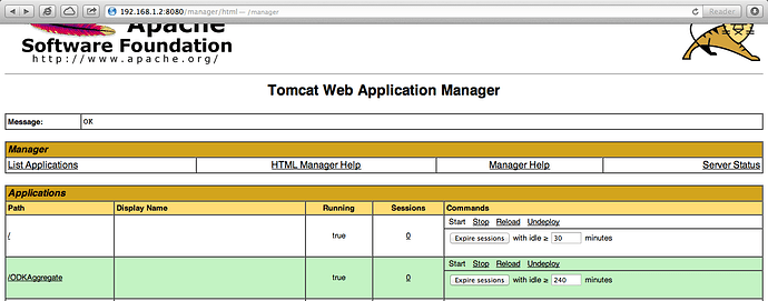

Hi Mitch,
From my laptop I am able to get the tomcat "it works" page up with 192.168.1.2
