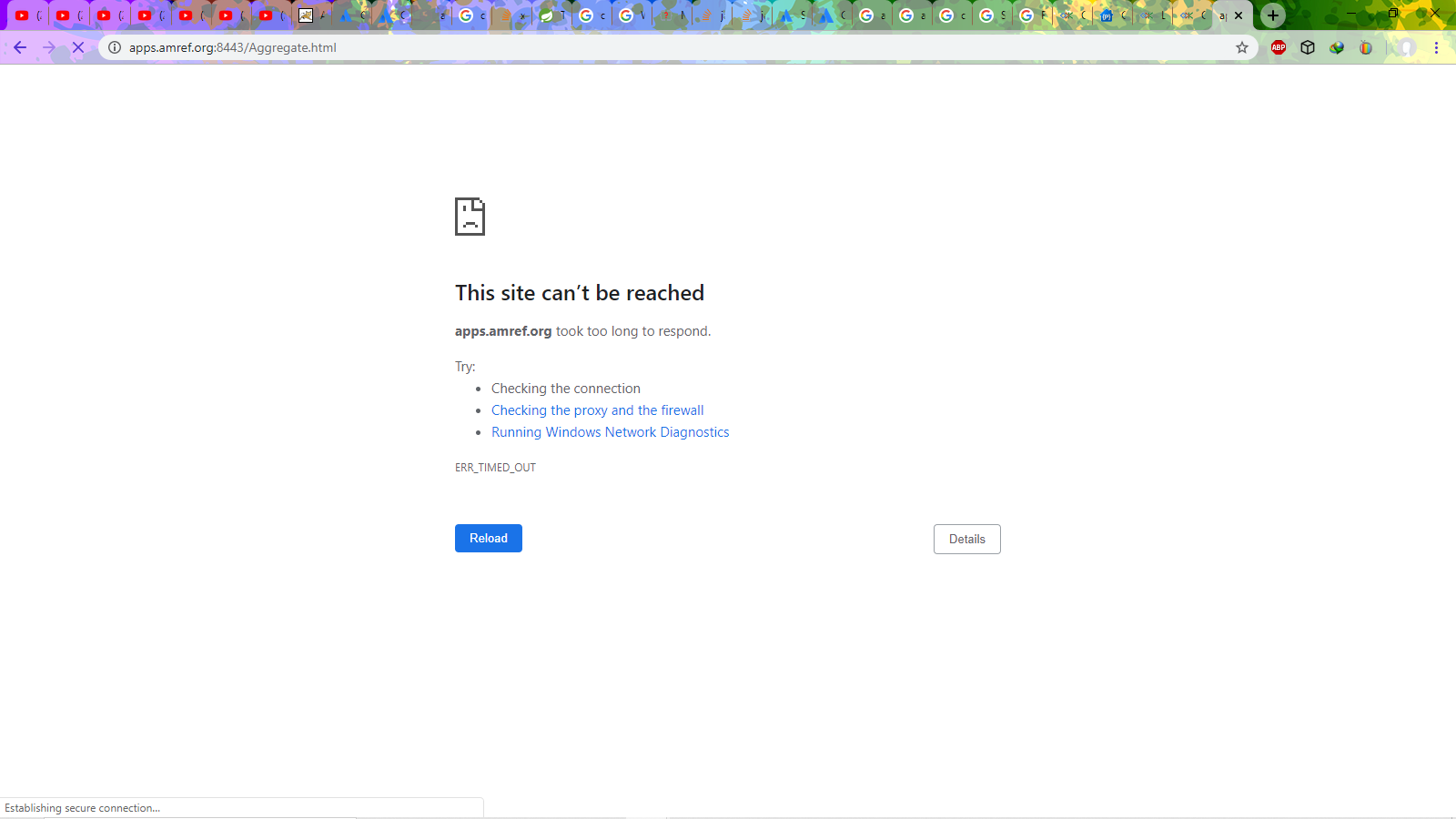

Hey guys ,ODK has been misbehaving,where it keeps crashing and we have to restart the tomcat service every time to restart aggregate for it to work.It may work for a few minutes then it stops working.The problem has been too severe that I cannot even pull files through aggregate or add any new forms as it gives different errors at different times.sometimes the error can be the site took too long to respond or problem persisting data or accessing data.Currently if I restart the tomcat service my aggregate is blank without any data.

Just try accessing the public subdomain address,you get this site can't be reached.
I gave the logs and screenshots
