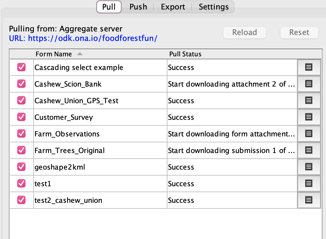

I'm having this exact same problem using a Silicon Mac Mini macOS Sononoma 14.2.1 and ODK Briefcase v1.18.0 and Java 8 Update 391 build 13 (1.8.391.13) jre-8u391-macosx-aarch64. I have 9 forms that are in the PULL tab and only 6 in the push tab.
Not sure of any way to move forward with this...
I tried uploading the briefcase log as well, but not sure how to do that as its only allowing image files. Below is one part that looks relevant and there were similar errors for the other 2 forms that aren't showing up. I think it has to do with multilingual forms. When I didn't specify a default language in the settings tab of the XLSForm and then tried to change the form language on ODK collect, the form crashed referencing "Français (fr)"

I tinkered around with the most simple form that was being rejected and it didn't like the "background-audio" question that was causing issues. However, once I removed that question it still didn't show up. I had to remove the second and third languages so there was only one language. I then did a pull, it completed and showed up in the PUSH tab. I then re-added the language columns, uploaded the new XLSX file to ONA, then did another pull, and it still shows up in the PUSH tab.
Is there a list anywhere of what definitions were supported? The whole reason I'm doing this is to compress images that were already submitted and replace them on the server so the overall dataset and each submission is way smaller. I've added a parameter for photo questions in the parameter column "max-pixels=1500" or "max-pixels=500" but its looking like ODK Briefcase isn't liking that either. Here is part of the log file as it relates to that.

I still cannot find out what's wrong exactly with the other two files. I know one has the max-pixels parameter, but the other one doesn't. Here is another part of the log that is showing things that look problematic, but I'm not sure what this is referring to:

I thought it was a problem with the "quick" appearance, but one of the files that shows up in the PUSH tab also has a several questions with "quick" without any issues. Not sure what the "ODKIncompleteSubmissionData: Javarosa failed to construct a FormDef. Is this an XForm definition?" is referring to.
EDIT:
I figured it out. There was a variable in the trigger column "${select_survey_type}" that was unnecessary. This was the case for 2 of the 3 original forms that weren't functioning. I will add that the "max-pixels=1500" in the parameters column is still there and is showing up with the following error in the briefcase.log, but that wasn't what was keeping it from showing up in the PUSH tab.
