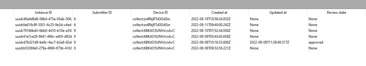

Image: what the API is returing (notice that instanceName is not present)

This is the data that I receive, none of which is user friendly and it's impossible to tell which submission is which:

Correct me if I am mistaken, but I think this is not really the functionality I am looking for, because this OData URL returns the whole submission data for each submission which could become an issue since our forms are quite extensive, whereas the regular API call returns only generic data about the submission (instanceId, submitterId, createdAt, updatedAt,...) and nothing else.
