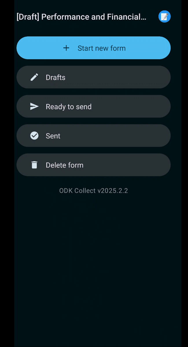

@Francis_Opiyo I just ran the form upload, but I couldn't attach the CSV because it said "This definition requires no attachments, so there is nothing to upload" so i can't upload the attachements is there a reason why this is so?. Just wanting to make sure i get it right
here is a an example of what i am explaining, here i can't upload the csv attachment
