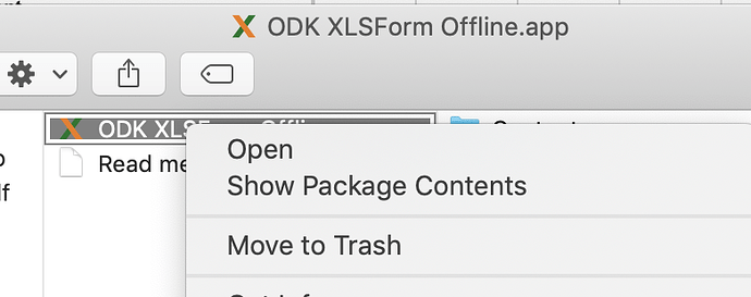

On macOS 10.7 or later, you may get a dialog on startup warning you that the XLSForm Offline is from an unidentified developer. Control-click or right click the icon of the app to bypass this dialog. See About Gatekeeper for more.
Thanks I got past that bit :slight_smile: I can see the app icon and the associated text note but it simply won't launch. I think it must be something specific to my Mac set up as I couldn't find anyone else reporting this problem on the forum.
Sorry you are having problems, @jo1. I just tried it on my Mac 10.14 and it works for me :sob:
To be clear, when are control-clicking, seeing this menu, and selecting open?
In your System Preferences, under Security & Privacy, in the General tab, at the bottom of that screen, what do you have "Allow apps downloaded from" set to.
