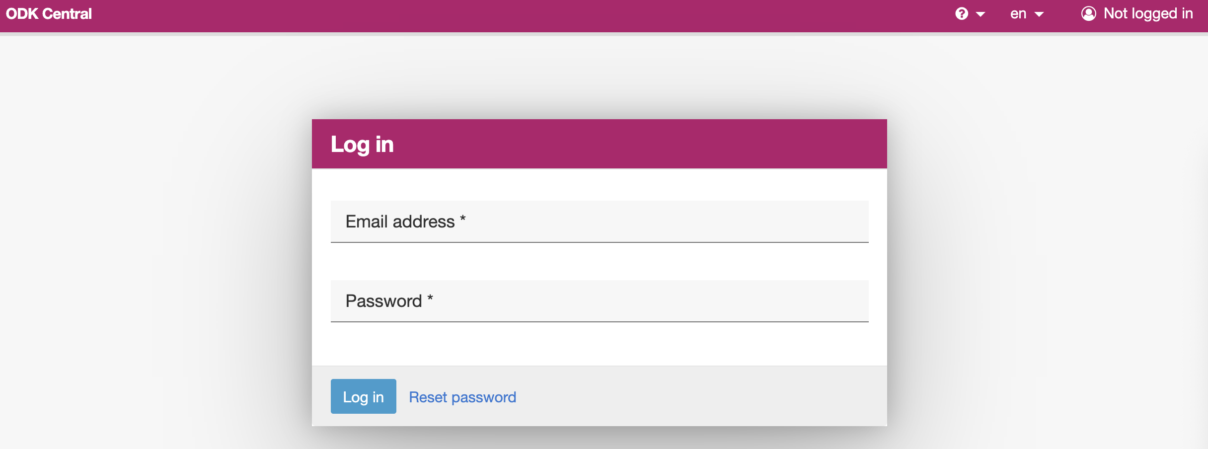

I am guessing that the keycloak-integration does login only for existing accounts, because ODK doesn't have any signup concept, for example:
[screenshot - {DOMAIN}#/login?next=/]

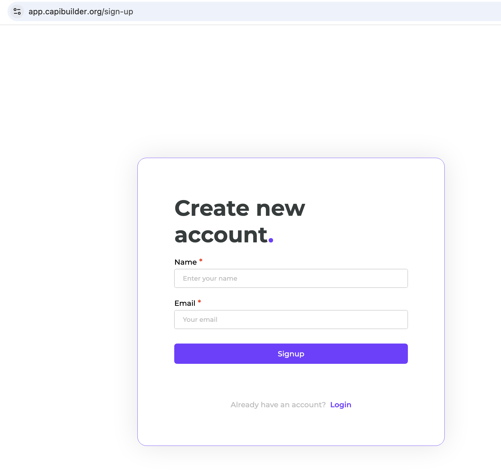

Earlier, i created the public sign up for the CAPIBuilder, a wrapper on top of the ODK API.
[Screenshot]
Rough plan:
  1. Sign up: For the org domain, i can use the CAPIBuilder to make a request to Keycloak, get it validated with the keycloack tenant, and get the credentials and send the request to ODK SSO endpoint.
  • Need to map the User roles with respect to the organization (e.g., User: ABC, role: Program Manager, Organization: ACME Corporation) shall be a Project Manager in ODK.
  1. Login: In the same way, user enters the login credentials to get validated througn Keycloak and redirects back to CAPIBuilder.
Maybe I am overlooking something in your plan, but with SSO currently making the ODK API inaccessible, how will that work?
