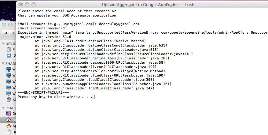

I am trying to run through the steps for ODK Aggregate "Installing on App
Engine (Cloud)". I always get stuck in step 5 as I try to put in my
password there's always an error (see screenshot attached). I also tried to
generate an app specific passowrd by following the instructions but that
failed as well. Any advice?

You need to install Java 7. Looks like you have Java 6.
