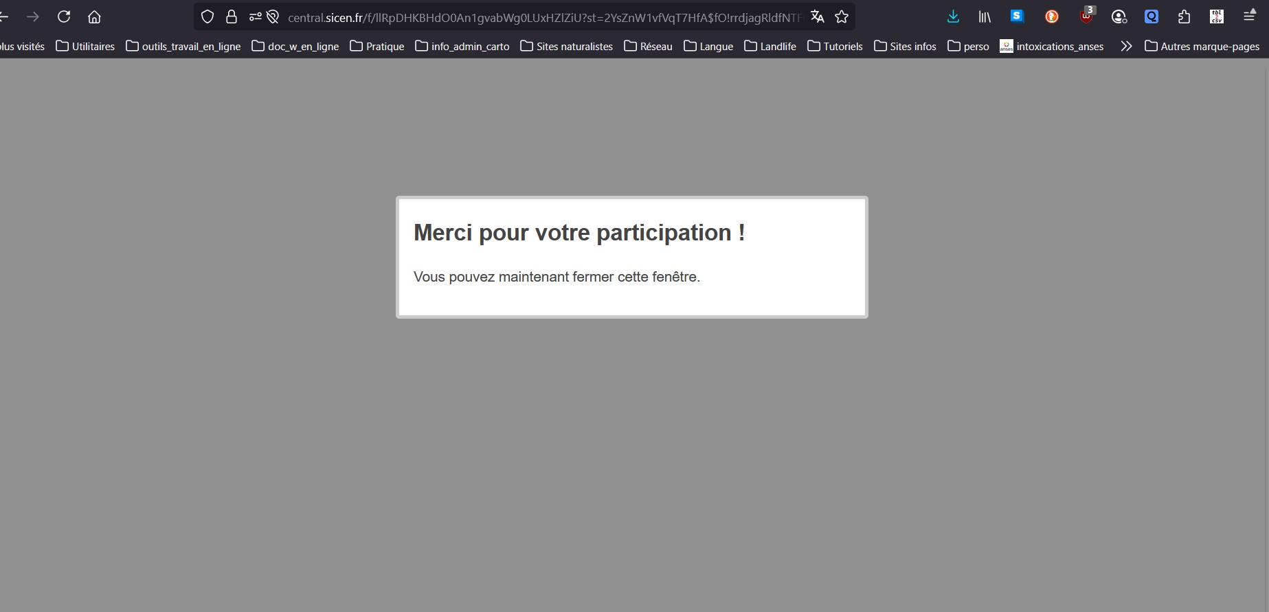

There are actually two problems with the webform, probably connected:
  • the generated access link is for multiple submissions but “behaves” like a link for unique submissions
  • we need to “re-click” on the link to get a new webform to fill and so the last-saved fields are empty
After the last Central update, the existing access link for this webform opened a "connexion” page to Central so I had to generate a new access link and that’s with this new link that we found out this issue.

Yes. It’s a form that people need to fill out several times, but when they click on the submission button, they get a message of “thank-you-and-you-can-close-the-page”. :wink: Just as a one-shot submission link, they have to close the page and click again on the access link to fill out a new form.
I didn’t try because when my colleagues brought that to my attention, I just tried to find a quick answer for them not to be stucked and they haven’t any account to Central. I remembered Mathieu had updated Central a few days ago and thought it may have changed some things.
So I generated a new link, which seemed OK (as they could access again to the webform without log in to Central) until they told me about the unique submission trouble.

I tried the “new” one and it opened a blank webform page.
At the end, looking more closely at both urls, letter by letter, I’ve found the difference: after our Central server’s url, there is “/-/” in the first link (the one from wich I removed the word “single”) and “/f/” in the most recent one.
