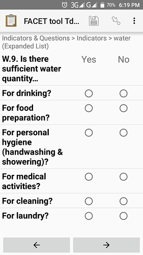

I am newly develop xls form and want to to design a multiple question and response in a list like attached picture.
Please help me how can i do this like uploaded picture item.

Hello, You can use all these questions in a group and set in that line of group appearance="field-list".
There are a variety of options for changing how questions display.
Check out http://xlsform.org/#appearance or scroll down to the appearance category on http://xlsform.org/ref-table/.
Additional details are available in the ODK documentation: https://docs.opendatakit.org/form-widgets/#widget-formatting-with-appearance
THANKS for these links.
To pull all the pieces together, https://docs.opendatakit.org/form-widgets/#field-list is the example to look at. Take a look at the field-list, label and list-nolabel appearances.
