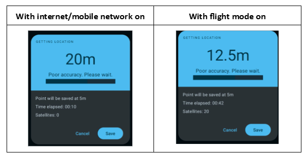

Now that I am thinking about it, would having access to the nbr of sattelite signals not also be a way to identify if the coordinates have been captured using the GNSS receiver vs an internet connection or a mobile phone network?
An example to illustrate that capturing the nbr of satellite would indeed allow us to identify if the coordinates are coming from the GNSS receiver or not (Look at the number of satellites):
