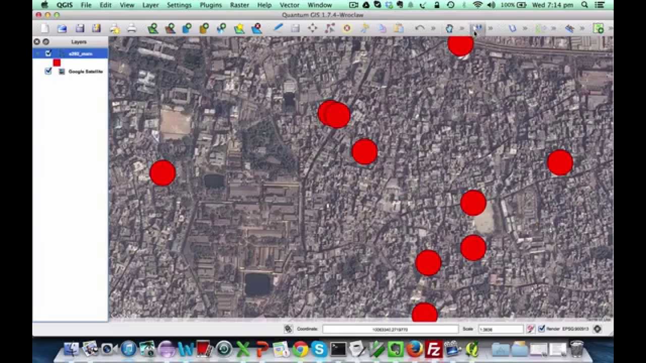

Smap Server stores repeated geopoints as a polygon or linestring in postgis
if the name of the repeating group starts with geopolygon or geolinestring.
Smap also supports the geoshape and geotrace datatypes and again stores
those as geometries in Postgis.
You can exports the results as shape files, this video shows how to do this
although the data was actually points in the video.
You can download Smap server from http://www.smap.com.au/downloads.shtml
regards
Neil
