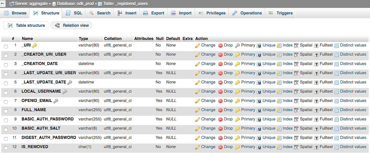

I just discovered this table called _registered_users with the following structure
My question is... Is it possible to register ODK Aggregate users programmatically using SQL insert to the _registered_users table?
If so, how can the values for these columns be generated? Especially BASIC_AUTH_PASSWORD, BASIC_AUTH_SALT, and DIGEST_AUTH_PASSWORD?
