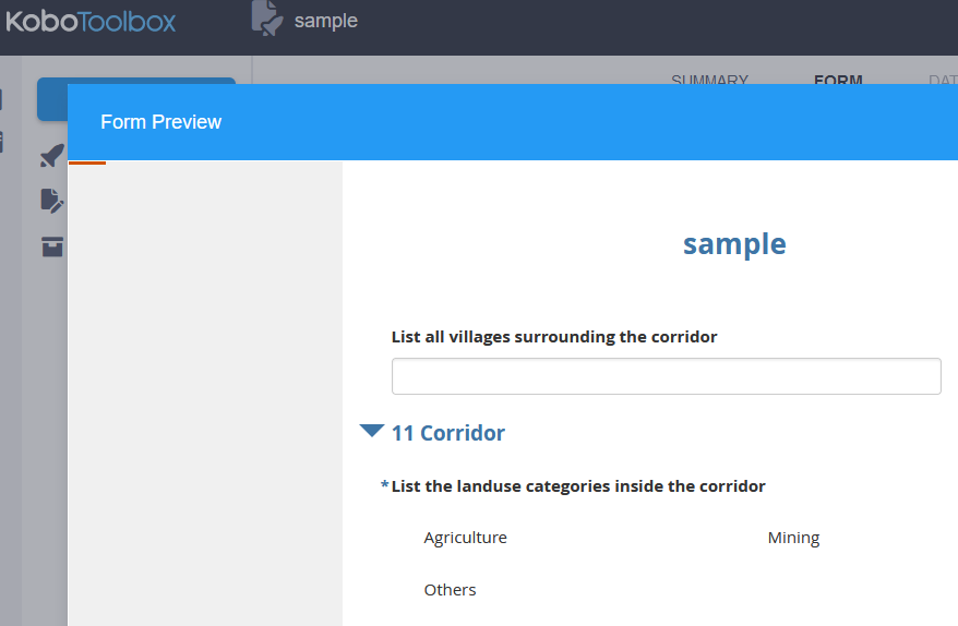

b) no-buttons with columns-n (or columns or columns-pack) shows a strange positioning (with Online validator https://getodk.org/xlsform/, but ok/different with KoboToolbox, see below).
a) Online validator: no-buttons without any columns appearance. (Same in KoboTollbox)
b) Online validator: no-buttons with columns-2
KoboToolbox
