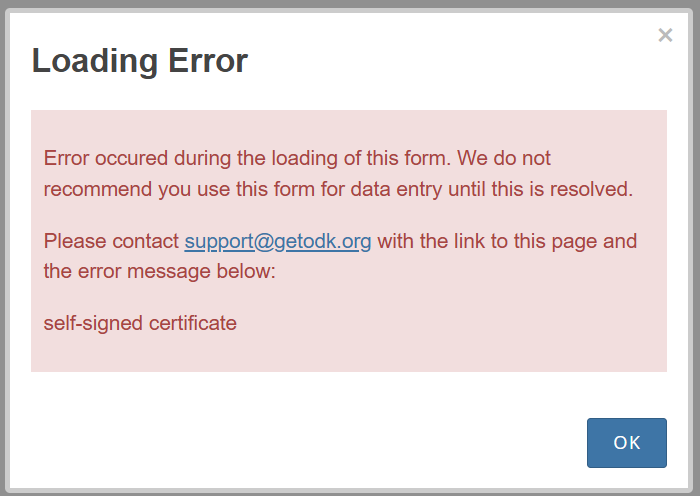

Host the Odk-Central locally with self-signed certificate.
Trying to preview a form: Gor the error: self-signed certificate
  1. Host the Odk-Central locally with self-signed certificate.
  2. Upload a valid form
  3. Preview the selected form

This is an advanced configuration option. Did you follow all the steps in the docs? https://docs.getodk.org/central-install-digital-ocean/#using-a-custom-ssl-certificate
I would also read through this thread and the threads it links:

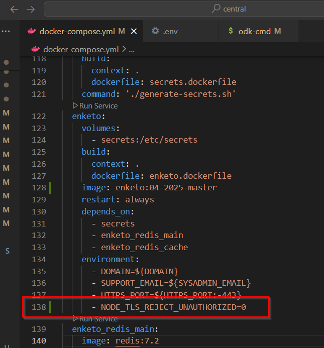

I'm pretty sure Enketo won't work with a self-signed cert. You could disable cert verification, but it's a horrible idea as far as security is concerned.
I'm also pretty sure Collect won't work with a self-signed cert unless you bundle it with a custom build of the app. You might be able to use ngrok (or something similar on the server) though.
@danbjoseph, The problem is that this is the development environment, and we do not have a public domain for this. Therefore, we have to use the self-signed certificate, which is not supported by ODK Central.

This allow me to move forward with my dev enviroment
